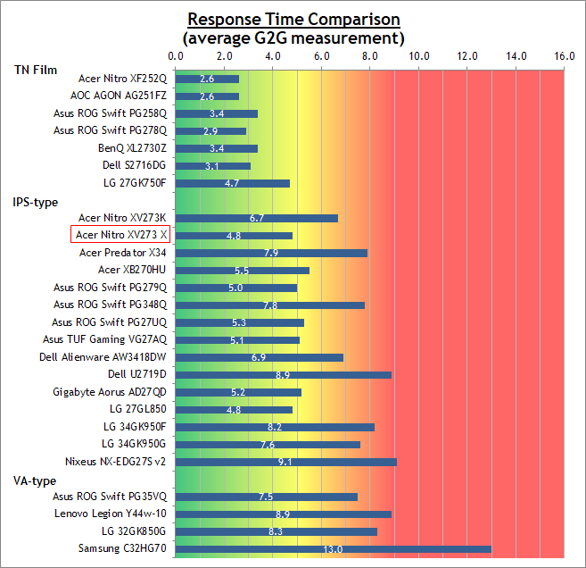

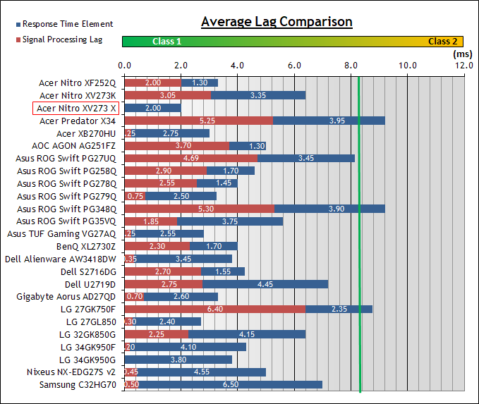

For comparison, although from a different website, the Acer Nitro XV273X (IPS panel like the Viewsonic Elite XG270):
1. GtG Avg: 4.8 ms avg @ 240 Hz
2. Motion blur reduction: 210 nits @ 240 Hz w/CR of 957:1 (it gets darker as you lower the refresh rate)
3. Compared to TN panels like the XF252Q and the XL2746, it's noticeably slower and probably what you could expect with the other IPS panels like the Viewsonic:
4. Input lag: 2 ms which is impressive and on par with the XL2746
For reference, I have an old Asus PG278Q and if you look in the charts above, it still beats out many of the new panels in GtG times which is disappointing as hell considering I bought this back in 2014-2015. One area the new panels have advanced is input lag though, the signal processing time on my PG278Q isn't very good and in comparison, even the new IPS panels blows it away. Since signal processing time is the actual "feel" you get from the monitor when doing actions, I think this could make a big difference when gaming. So right now, I'd like to see hard numbers on the XL2746's DyAc+ max brightness because unfortunately the Korean website left that out and it is the single piece of information I need to decide whether to go w/the Zowie or the IPS panels like the Viewsonic/Acer (Alienware is not even a consideration since it has no blur reduction).
Chief Blur Buster what are your thoughts on this?

With real response times on IPS panels being in the 5-6ms range I wouldn't go faster than 165 Hz on one.
Yeah realistically they top out around 180 hz before they get errors due to not being able to keep up with the refresh rate. Still that's pretty good but definitely not where TN is at.

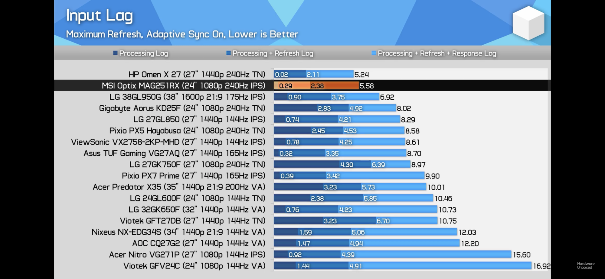

On that note I've starting looking at the Gigabyte KD25F. Take a look at this video:
Editing as I may be more inclined to try this:
Don't bother, I had that monitor (kd25f) and returned it. Their antiblur darkens way too much so it sucks, that's why I sent mine back. It also had higher input lag than other monitors, some of the IPS ones have better input lag results. My 2015 PG278Q has better input lag results which is just pathetic for gigabyte.
Even that hwunboxed video you linked above shows it:

Got the MAG251RX in today and played a few rounds of PUBG and some Destiny 2. I am still tinkering but 240hz with Motion Blur w/ brightness@100% and isn't as dim as my PG279Q. My wife can't stand watching me play FPS on PC because it makes her motion sick, and she was shocked at how much a difference this made.
BenQ probably handles the blur reduction best so far with the least brightness impact. I don't know how much DyAc differs from when it was called BenQ Blur Reduction that it's called on my 1st gen 240Hz but it doesn't limit the brightness a whole lot, I mean I went from 23~25 to like 36 brightness turning it on for similar brightness feel. (EDIT: Okay I forgot that was with 144Hz that I personally use, I suppose at 240Hz the brightness drop will have an even bigger impact just like overall image quality as well). It's not like you are forced to running 240Hz just because the monitor supports it, find what's your sweetspot in image quality vs performance I say whether that be 144Hz or some custom setting 165, 180Hz or whatever.
And then you can obviously tweak if you want better brightness levels or better motion smoothness but I left it on the default settings (without the tool installed) as I thought that worked best
I think the 2746S is going to be the fastest 240hz monitor, however the MAG251RX has 25% higher peak brightness and looks great with motion blur reduction. The visual hit detection queues are far more clear, and have improved my performance. I think the MAG251RX has me skill capped with a picture I am satisfied with.
I tried the MAG251RX and I really loved how responsive it was. The motion blur reduction introduced too much strobe crosstalk for me, however. I ended up returning it because I really couldn't go back to 1080p from 1440p. The blurriness was too much for my eyes :(. I'm also older and less competitive these days.
