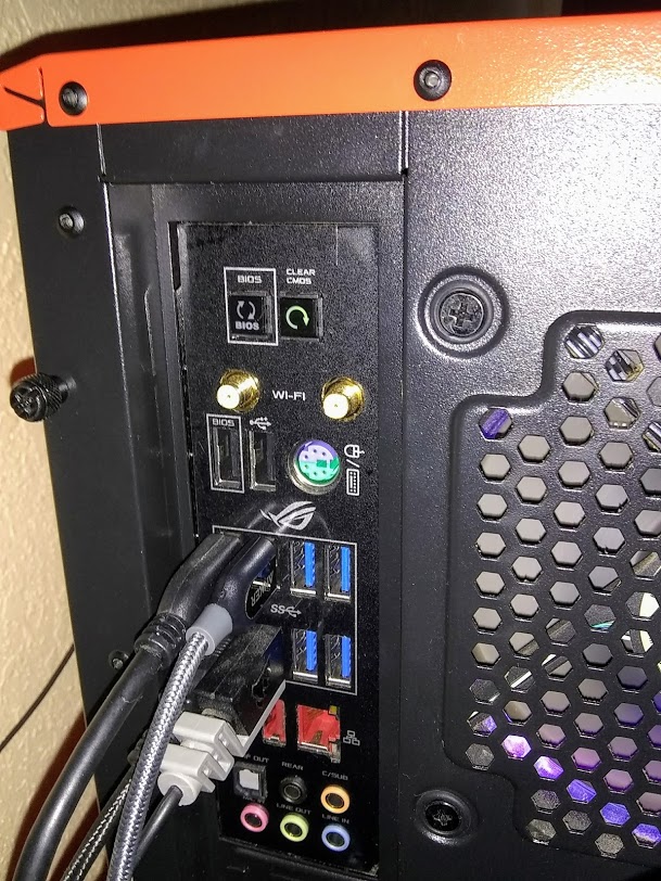

i new it had something like this (probably cause mine has same function) I remember reading something but never had to mess with it
nPHziFlaWmo5ALY3Ihzkksgw8YbdCo1kKIq7D2apQYxYtW8gCMTWHJSG_65TZqZxvFE85lbKKHfEWAxgeuM=w609-h812-no.jpg
the one that says BIOS:) My box and manual are packed away but i remember reading about it at one time. (Its a pretty advanced feature and im surprised the asus people didnt ask him about it)

I believe the required filename for the BIOS file for the Crosshair 8 Hero is C8H.CAP.
I got it man ;), just found it funny that the first link was broken. I'm also not sure how to follow step #3?
3. Insert the your motherboard into the POWER SUPPLY and keep the motherboard Standby.
:p
It is essentially just telling you to make sure you are plugged up to the power supply so that it has power but keep the computer OFF
Note that if the light on the BIOS button quits flashing and stays a solid blue, ut didn't do it. The light goes out entirely when it completes successfully.
It appears to be doing it now, didn't want to work with the first 3 usb sticks, 4th one was the charm. I was just joking about the power supply #3 question, bad translation I'm assuming.
