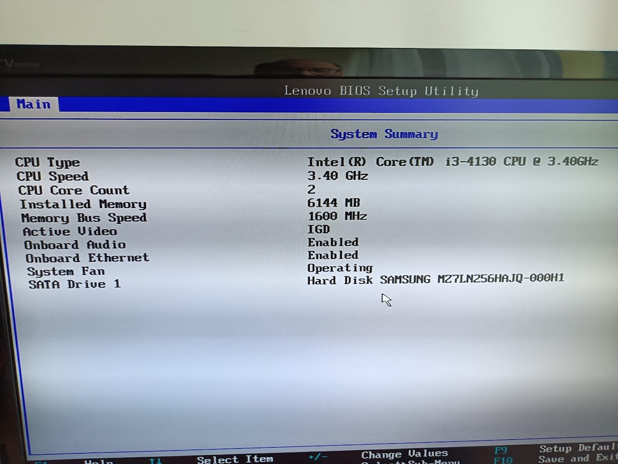

I have M73 and i3-4130
The CPU clock speed does not drop when OCCT is under load. It is 3.4GHz on all threads. The temperature reaches 90 degrees C.
I bought an i3-4350 for around 10USD which has 3.6GHz and a better iGPU HD 4600 and we'll see if it works.
I bought an i3-4350 for around 10USD which has 3.6GHz and a better iGPU HD 4600 and we'll see if it works.View attachment 477848

M73 Tiny with i3-4130 (HD4400)
Cinebench R20 764
3Dmark Firestrike 579
720p/Low avg/min fps tempreture up to 86C
Dirt 3 61/52
Bioshock Infinite 27/19
Mtero 2033 26/7
Dirt Rally 34/28
Tomb Rider 43/33
OCCT up to 92C
An interesting fact is that the similar year-old HP 705 G1 Desktop Mini with the Kaveri A8-7600B APU has 50% better GPU with standard throttling, and after turning off Throttling (app AMD Overdrive with the "Turbo Off" option) it achieves twice as much results at the cost of about 90 degrees Celsius
HP 705 G1 (lock / unlock)
Firestrike 741/1252
The CPU, however, is only weak with 401/556 points in Cinebench R20
Yeah AMD had better onboard graphics for sure, but that is dramatic
The i3-4350 processor of course works in the M73 Tiny but it required the use of Intel XTU. On the standard settings, after turning on the OCCT, it quickly reached the power limit and reduced the clock to 3GHz. It helped to set the Intel XTU -0,150V voltage core offset. Now in OCCT the loaded CPU reaches 94 degrees but holds 3.6GHz. The results in Cinebech are around + 5% (5.8% is due to the clock difference i3-4130 vs i3-4350). But the biggest gain was on the GPU with the HD4600 being around +15% more frames.
