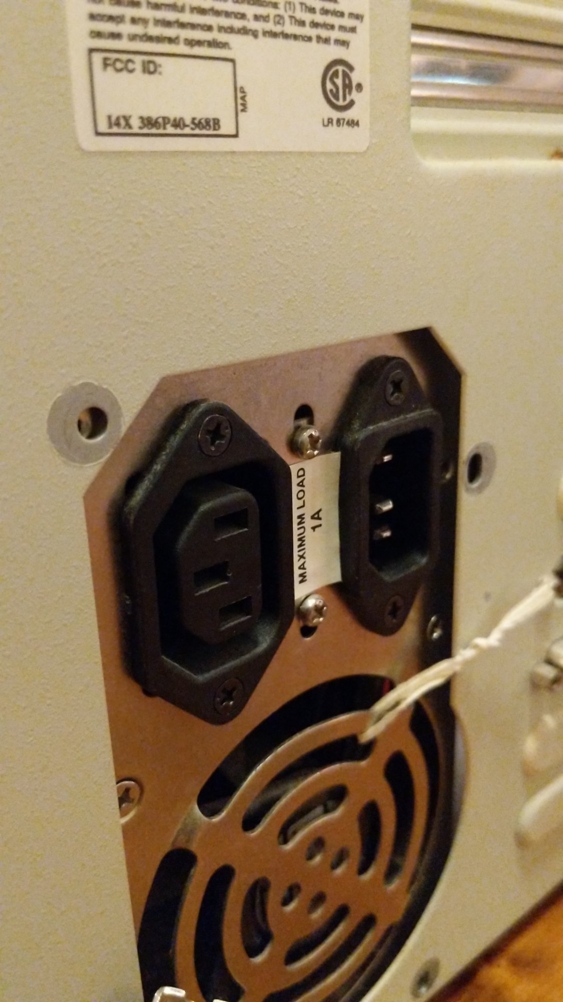

I love their power supplies that can also power the monitor. What is the cable called? I looked around a while back and had no luck.
I dont remember the proper name for it, but I know a lot of the early IBM monitors had them attached to them
Although once monitors got bigger they stopped using that plug, although the plug remained on PSUs for a very long time after that even though it was not safe to run them that way due to the current draw of later CRTS
The last time I used it was on an old pentium 75. I thought maybe it was a cable I could buy, not realizing it was part of the monitor. Shame.

I am sure you can buy them still, just I wouldnt trust an old PSU to even run one of those old 12-13 in CRTS.
I'll just stick with its own power. Plugs are not hard to come by lol.

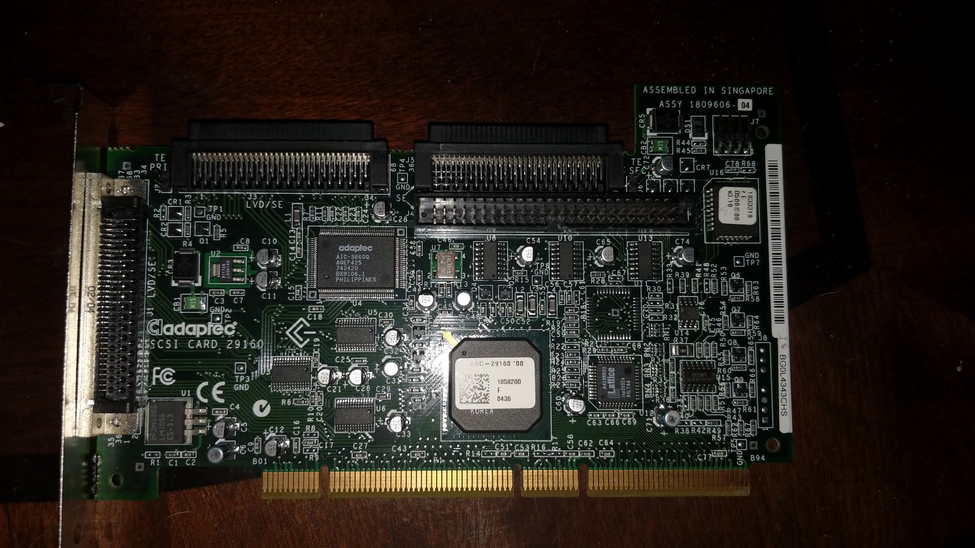

I don't have any experience with SCSI cards or drives, but I think this is one?
Lol.... Says SCSI on the left. I'm smart.
Got it for $2 at a thrift store months ago. Only for it because it was random.
Yeah that big 50 pin and the trapezoid shaped 68 pin are always a giveaway. Plus adaptec made a lot of SCSI cards, most of the ones I have are from them along with a few tekram and off brand ones.
Back in the day SCSI was really awesome, but it was spendy to get it set up. The cards were expensive, the cables were expensive, the drives were expensive but very fast, and even the cable terminators were expensive. It was nice having 10 and 15k rpm drives though, they were the SSDs of their day. Good old IBM ultrastar, seagate cheetah, and maxtor atlas drives, plus a lot of the good early CD burners were SCSI also.

Good call, those PCI-X (64-bit PCI) Adaptec SCSI controllers were extremely reliable and had solid performance back in the early to mid-2000s, and I still have quite a few of them.
The 29160 (Ultra160 SCSI @ 160MB/s) was the mid-range of those units, and was my favorite to work with back then, and I saw them in use up until around 2007 when SAS finally made parallel SCSI obsolete.
The 19160 was the entry-level card (small maximum number of connected devices), the 29160 was the mid-range card (moderate amount of connected devices with best system compatibility), and the 39160 was the high-end card (lots of connected devices but compatibility was minimal outside of servers with large BAR and IRQ counts).
That was a nice find!

I can't believe these SCSI controllers are almost 20 years old, and I remember when they were new-to-market and were used in quite a few servers I maintained and upgraded at the time.
This really makes me feel old... :whistle:
Exactly!

Since it has a universal PCI-X connector, you can see if it works in a normal PCI slot, just make sure there's room for the connector to overhang the back of the slot. Some cards do, some don't. In the case it does work, the card will be bottlenecked by the narrower slower 32 bit PCI.
They all work in a standard 32-bit PCI 33MHz or 66MHz slot (assuming it will fit) - you are right, and we did that very thing with this exact controller back in the day when on a budget!

I love there power supplies that can also power the monitor. What is the cable called? I looked around a while back and had no luck.
These can still be had (the cables) some PDU's use that type of plug.
You can get a C13/C14 extender those will fit right in and the C13 will go into the monitors power socket or you can get a C13 to a NEMA 5-15R (Standard 125V/15A US style wall receptacle type of socket)
Forgot this is the complete IEC 60320 specification page on Wikipedia

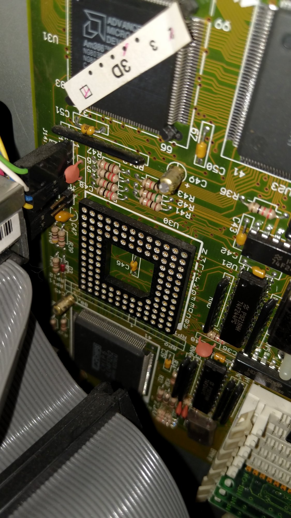

Just some pictures of the inside. Has a slot for cache, generic socket 7 (not sure if this is a SS7 or not).
It can support two types of memory! I think this is the only board I own that does.

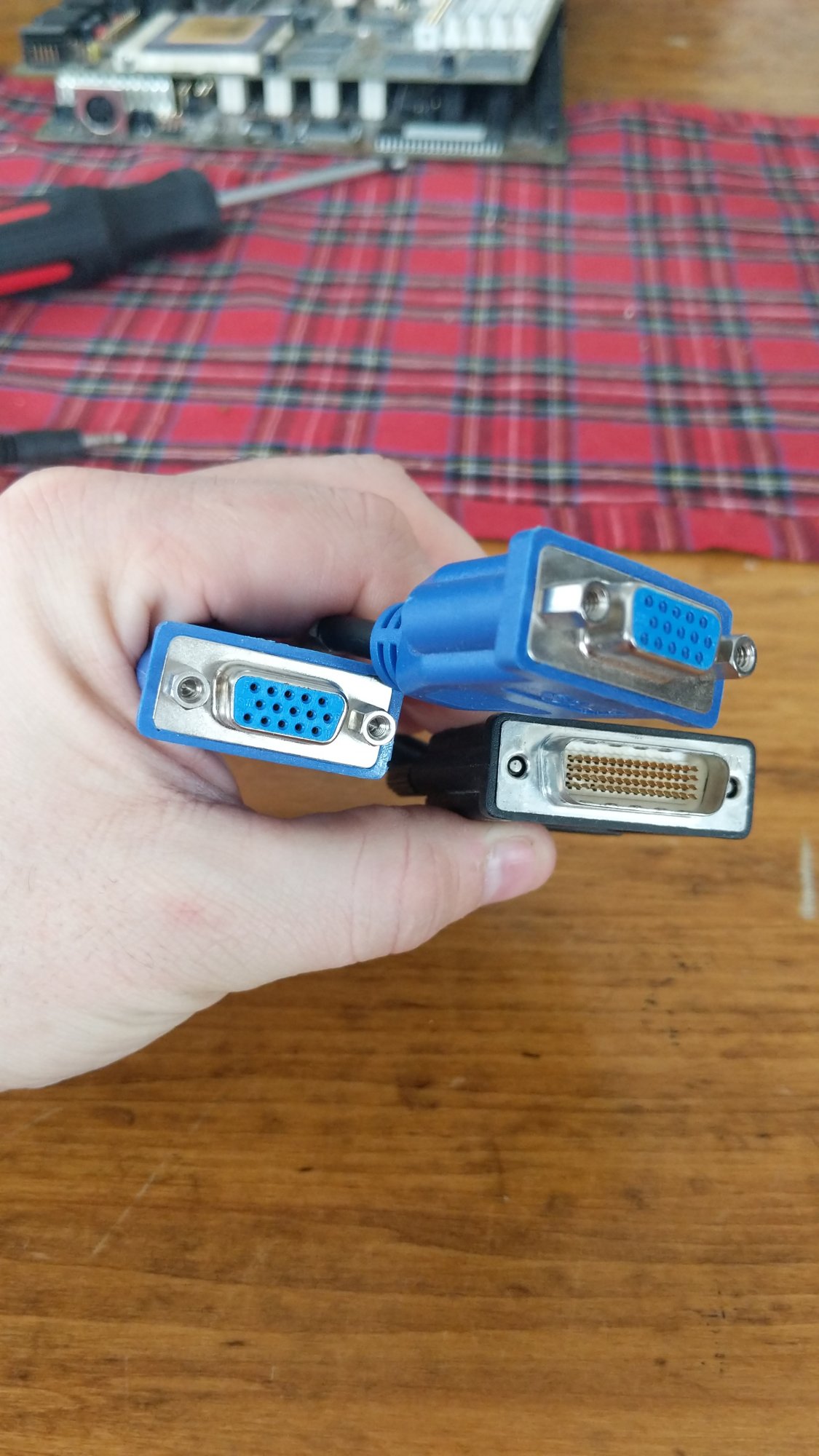

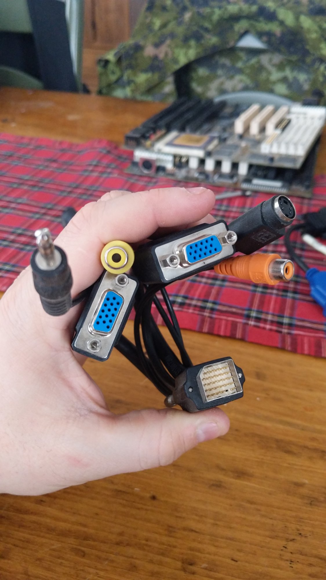

Meant to add these random cables. Pretty sure the first is for a matrox and the second is for an ATI AIW card.
The first one looks like a DMS-59 cable.
I've used a lot of those with SFF GPUs like low-end Quadro NVS and FireMV GPUs (way before micro-HDMI and mini-DP were a thing), and were mostly used for 2D workstations needing multiple (2-4) displays in such a form factor.
I've seen the second one before back in the 1990s and early 2000s, but my memory eludes me as to what the connector is called.
A little googling says it's a dual VGA connector. Pretty uncommon.
Yep, and others are dual-DVI as well - still have one in operation at work.
Here's an older AMD/ATI 2400XT with the DMS-59 connector:
You're right, these weren't very common connectors, and really were only used on SFF GPUs for 2D displays.
I believe the primary usage was for 2D graphs, stock trading, etc. - mainly business applications.
I used to use them for playing WoW on a Quadro NVS 280.
2D performance was fine but it was definitely no 60fps 3D performer, and these were really the only GPUs to utilize this connector type.
Mini-DP made DMS-59 completely obsolete.
Even the Quadro P600 can have up to four mini-DP 4K display outputs in a single-slot SFF design.
AMD was in love with LFH-60 and DMS-59 for quite a number of years on their low profile cards. They used it from the x300 series all the way up to the HD 5450 and maybe a bit into the HD 6000 era.
The second connector was used on the All in Wonder 9600 series. I have two AIW 9600 Pro cards that use that pigtail. Strangely, the AIW 9800 Pro used a regular DVI port.
