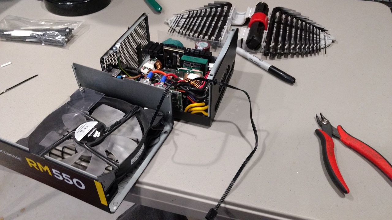

I did exactly this to my RM550. After the swap though, it seemed like the PSU refused to turn on the fan when it was under load (the RM series don't spin normally until they hit a predefined load %). So, I popped a grommeted hole in the side of the PSU casing and now control my PSU fan with a mobo header.
I did exactly this to my RM550. After the swap though, it seemed like the PSU refused to turn on the fan when it was under load (the RM series don't spin normally until they hit a predefined load %). So, I popped a grommeted hole in the side of the PSU casing and now control my PSU fan with a mobo header.View attachment 31603
