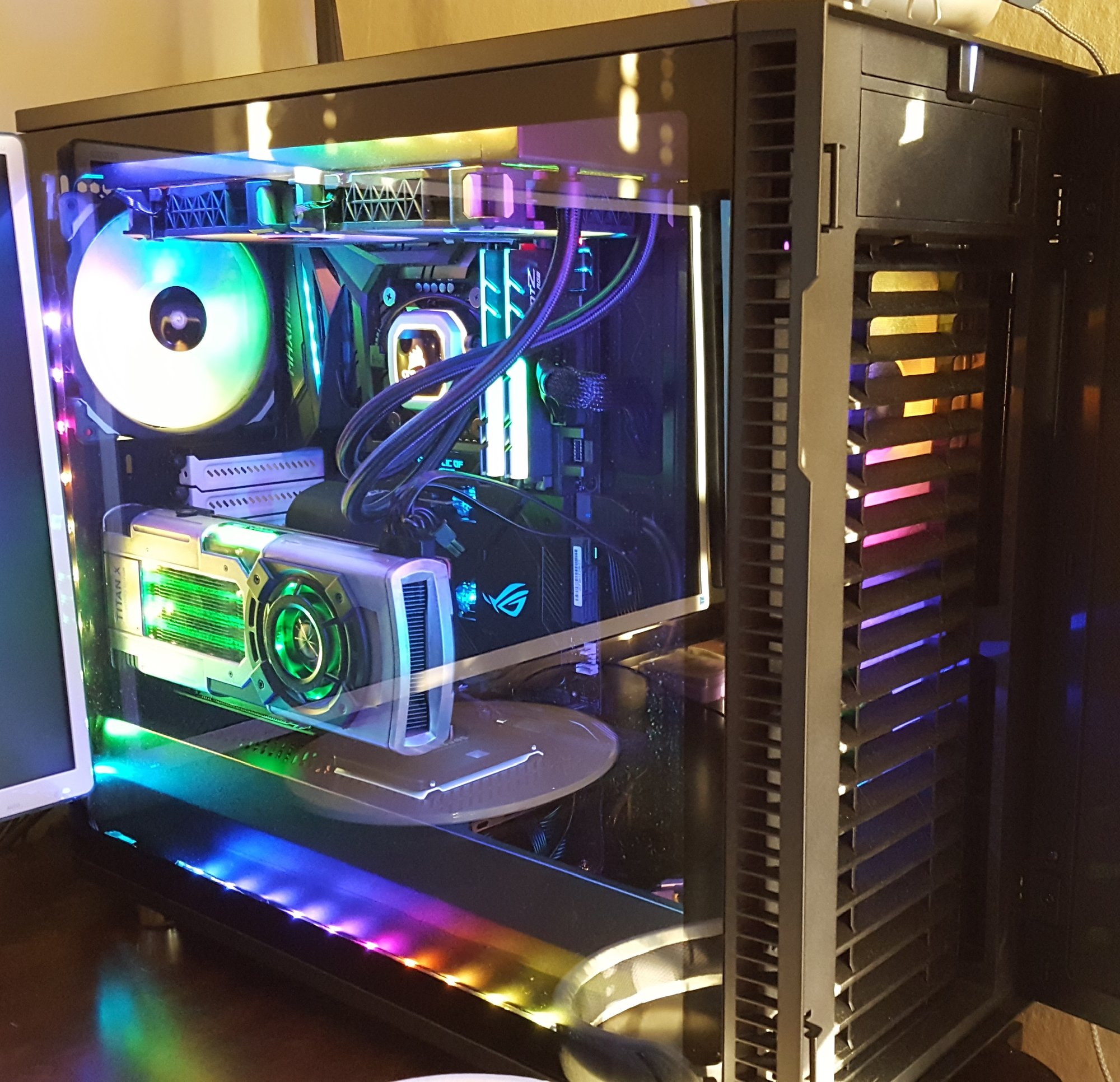

Fractal Define R6 is a good mid size tower with a 5 1/4 drive bay. Plenty of room for oversized video cards, storage, and coolers. Be aware that if you use 280mm or 420mm radiators in the top the case must be in "open" configuration (drive bay panels moved back toward motherboard tray). Also long top mount coolers may interfere with some 5 1/4" drives. There is also plenty of room in the front for up to 280mm/360mm cooling also.
Open layout with standard video card mounting and full disco light vertical GPU mount.
