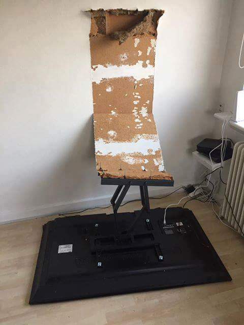

I saw this pic recently,
lol thats what i was gonna say would happen! the "safety cable" will ensure it rips a huge chunk of the wall out when it goes.
Rofls, while funny, it doesn't necessarily discount what I posted. They specifically tell you NOT to get a pull out mount. It's flush only, so you can't move it.
Looking at the mount in that picture, is not even meant to be studless. That's meant to be in the studs.
