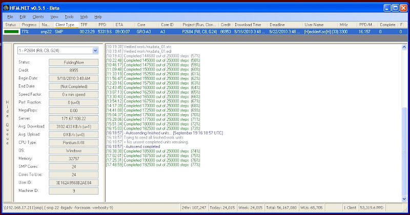

Had a chance to "burn in" some new hardware over the weekend. For anyone wondering What a Dell 710 server with Dual Xeon x5680 CPUs running at stock clock 3.33 GHz can do here it is.
Native Windows 2008 Server x64 Standard without HyperV
Current Fah Console SMP Client
SMP -22
P2684
TPF 23:29
Too bad these systems cannot be overclocked like an EVGA motherboard.

nice setup.. if its doing 53k PPD on a 2684 it should break into the 70k PPD range on the 2686 WU id bet..
3.466GHz with turbo. I'll bet it would push 100K ppd with -smp 24 and a 2686 or 2692. My SR-2 at 3.564 only does 110K ppd, and this thing isn't much slower.
So you found smp -24 to be workable to gain more points over smp -22? One of the next tests was a maybe trying an smp -24. But now I think I will check the box at 8PM and do the swap.
Well, I guess I can't really answer that as I have never run anything but -smp 24. I can tell you that I beat your frame times on this machine by 4+ minutes on a 2684, and I shouldn't be based on your clock speed versus mine. My memory is running a lot faster than yours and I am running 100 MHz faster, but that shouldn't equate to 4+ minutes I wouldn't think. If I had a 2684, I'd back mine down to see what my frame times are at 3.47. Unfortunately (well, fortunately for me), my machine currently has a 2686.

Just to put this to rest, I ran some actual numbers on my machine:
Dual L5640s @ 3564, 12 Gb memory @ 1584 triple channel
P2686 (Run 3, Clone 19, Gen 15)
-smp 24 - 14:34/frame ~110K ppd
-smp 23 - 14:58/frame ~107K ppd
-smp 22 - 15:03/frame ~105.5K ppd
So -smp 24 is by far the best configuration. The difference between -smp 23 and -smp 22 is minimal, but at these speeds, the ppd difference more than you would expect.
