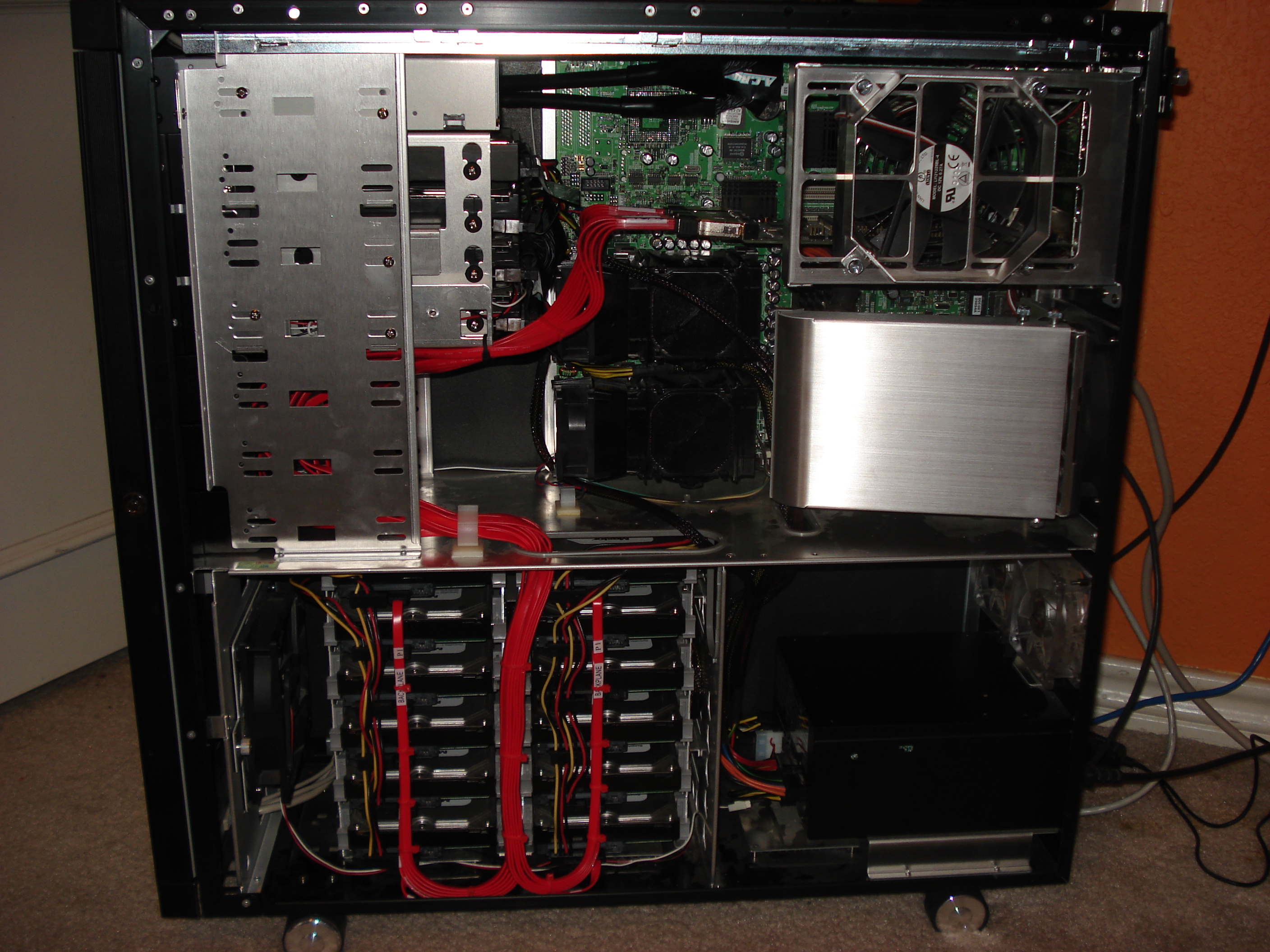

Server specs (picture):
Dual 2.4ghz Xeons (Gallatin)
1.5gb DDR266 (6 sticks)
15 Seagate 7200.10 drives (12 attached to an Areca 1130ML)
Random boot drive
Random boot drive
