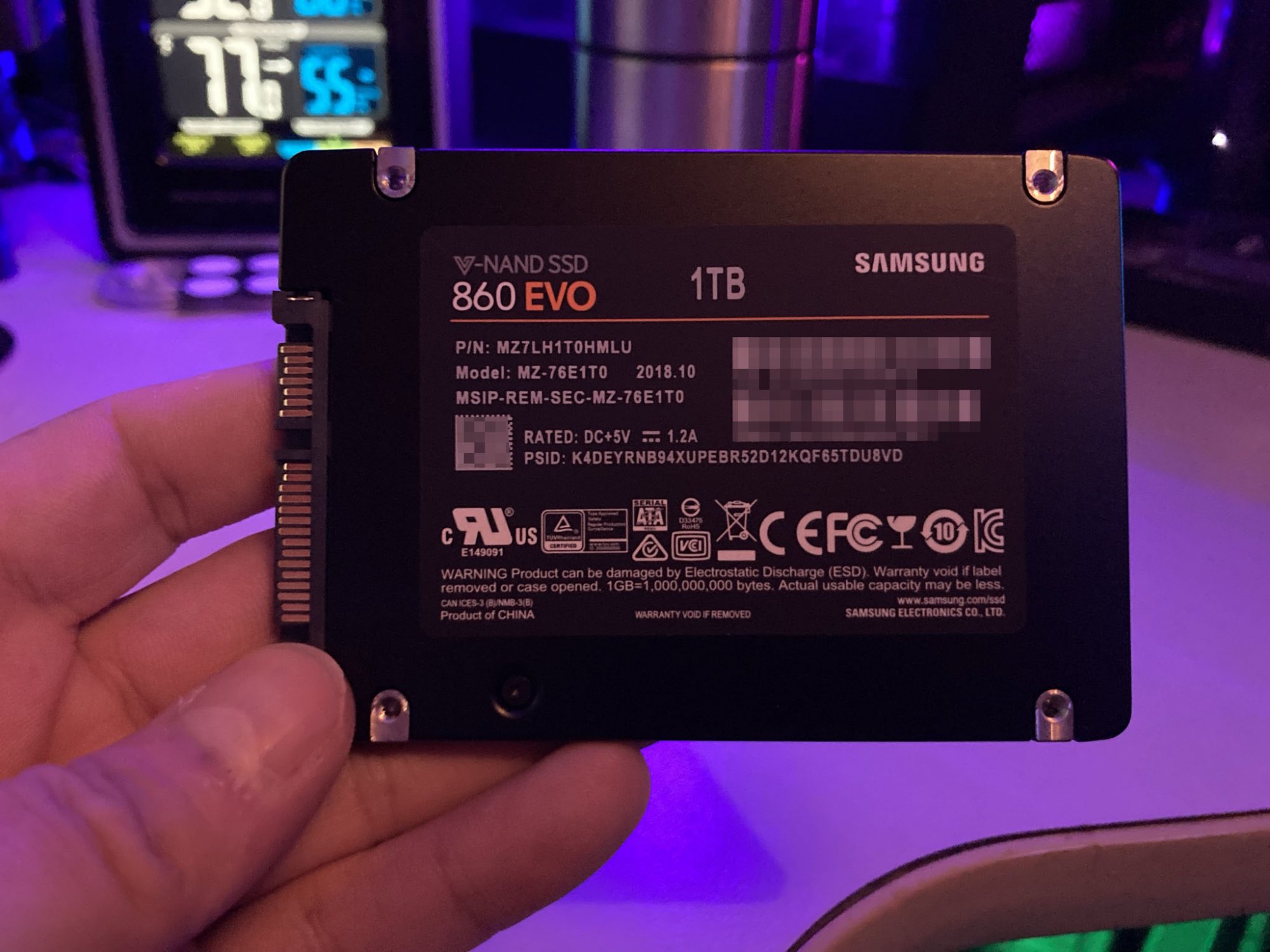

I happen to have an 860 EVO 1TB from 2018 in my drawer. Does yours look like this one?
Yep pretty much, the 1TB is raised a bit off the line like mine is and the number 860 is not as thick as the EVO wording so thats a mirror.
