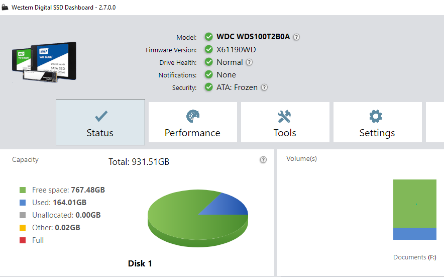

I use the Western Digital SSD dashboard software to ensure the firmware is up to date for all SSDs. The program reports that health is good for all three SSDs. One interesting thing I found was the software shows my two WD Blue drives are slightly different. Screenshots are attached. It looks like the model # and firmware version are different even though the drives physically appear identical.
