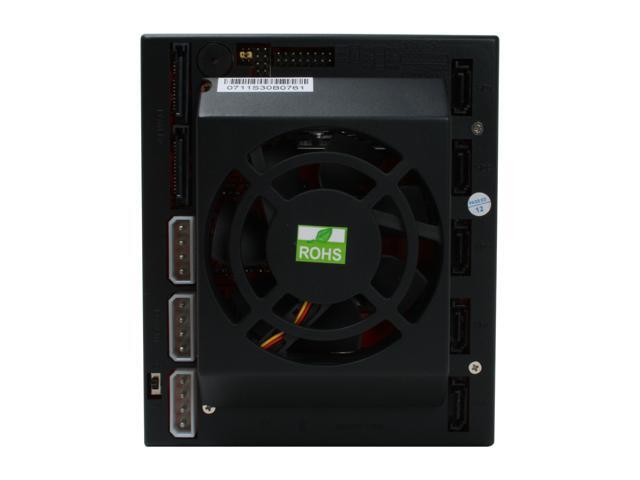

http://www.newegg.com/Product/Product.aspx?Item=N82E16816215047
http://c1.neweggimages.com/NeweggImage/productimage/16-215-047-06.jpg
That's the cage, and on the back you can see how I can't exactly mount a 25mm fan in there, and a 15mm fan would also be difficult to mount as the screws would be 5mm too long (I would need a LOT of spacers/washers to get that to work).
