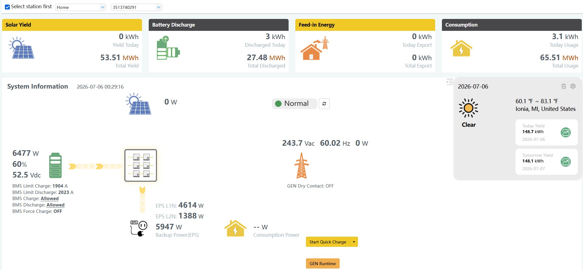

I bought this house/property 3 years ago and went all out lol. I diy'd the entire install (did hire an electrician to move my main power feed from the gridm moved it from the house to the pole barn). I Love seeing my 9 dollar electric bill now instead of 700, but of course that was at a ~100k out of pocket cost (got 30 percent back with solar tax credits though, so about 70k out of pocket). I have 5 EG4 6000XP inverters in parallel (would have went with 3 12ks if they were out at the time I purchased them). I have 200 KWH of lifep04 battery storage, those are all diy as well. I have 50 of the panels on angle adjustable ground mounts I built, 20 on a non adjustable ground mount, 20 on the pole barn and 10 on the solar shed. Was a fun project and thankfully the permitting was not as scary or as hard as I feared. Passed final inspection the first try. :) Most of my batteries are YIXIANG diy cases with jk bms's and Eve MB31 cells, a few Gobel Power ones (basically the same as the YIXIANG ones though). And 75kwh of them are CATL cells (pretty much the same as the eve cells) with jk bms's (all in parallel too and closed loop with communication with the inverters).
If my batteries are dead and full sun I can get over 250kwh in a day, so enough to fully charge the batteries and enough to use in the house/shop. This systme has been up for a little over 1.5 years now, the first year was only 24k watts of panels, added 16k watts more last november. I have yieled 53.5 mwh from solar and used 65.6 mwh. So about 84% of my electrical needs have been met, a few months in the winter we do not get enough sun and all my heat in the house and pole barn is electric.
Array is impressive but you capacity is absolutely nuts at 200 kw/h! Even then, getting to 100% requirements is nearly impossible if you have a week of overcast during the hottest or coldest times of the year.
Still, how did you end up dropping $100k? Quick estimation, $20k batteries, $8k in inverters, $10k panels and mounts, and around $2k in cable, wiring, fuses, misc... $40k total or so.
What am I missing?
What am I missing?
Was more around ~25k in batteries, 8k inverters, 12k in panels, 3k just for the 200 amp wires to run from my solar shed to house (~300'). at least ~5k in other wire and accessories/tools, disconnects, bus bars, shunt, all the cabling for the batteries (like 250 dollars for 20', need like 6 of those alone etc), 7-8k for the concrete for the solar shed and all the footings for the solar mounts, ~4k in lumber and materials for the solar shed (I built it myself, 12 x 16) ~4k for all the lumber for the ground mounts, ~2k for the solar roof mounts and hardware, paid 12k (well 15k, but that 3k cable was part of it) to the electrician (he and his helper were here for a week), he also replaced the panel in my house to a 200 amp one, replaced the 100 amp automatic transfer switch on my generator/house and put in a 200 amp one (those are like a grand alone, since I was now running 200 amp to the house and not 100 amp anymore so the transfer switch had to be replaced), he put a few panels in the solar shed as well, all ac side stuff. a couple manual transfer switches so I can switch my pole barn and house independently from solar or grid, all needing that expensive 200 amp cabling, run from solar shed to pole barn is ~60', had to do that with 2 of those runs. Can't think what else off the top of my head, it adds up quickly and you end up needing a lot of shit, can't imagine what a solar company would charge for something this size, at least 200k or more I bet. Ohh also forgot I had maybe 3k in engineered stamped plans for the solar install itself and the ground mounts I diy'd.
I know it was ~100k because I have every receipt, I needed them all for the tax credits. :)
