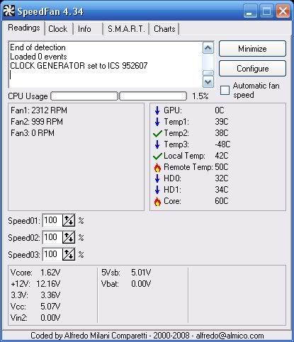

Here's a capture from SpeedFan. I think my system is running hot. :(

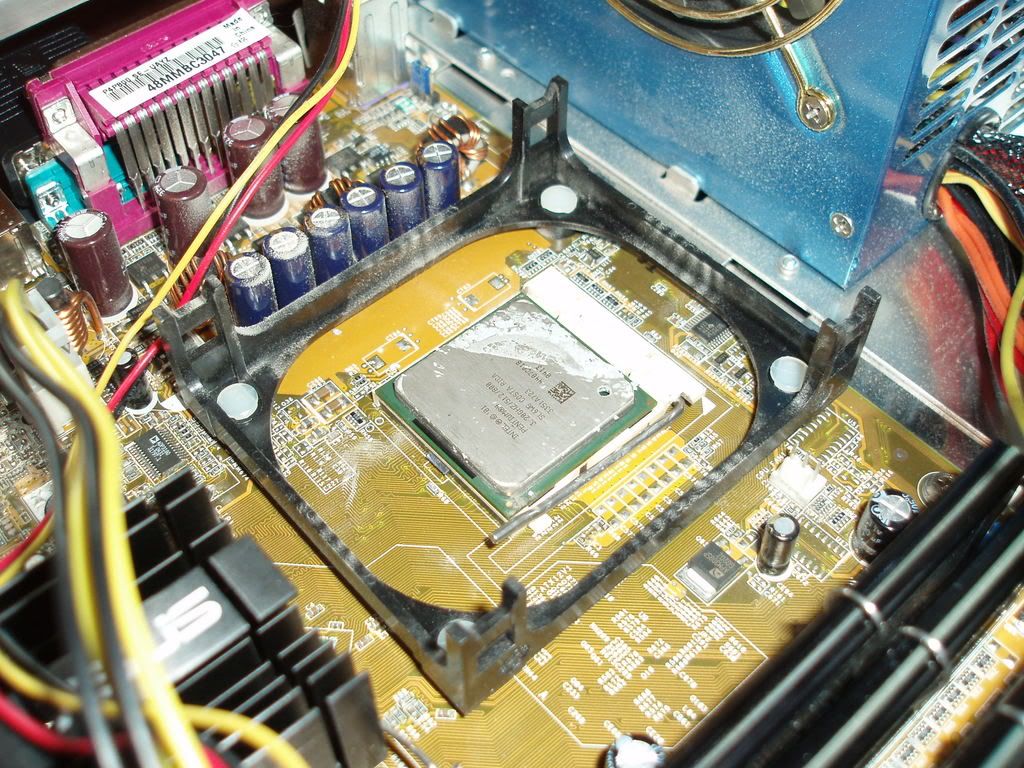

I forgot to get a set of wire brackets to mount the second fan, waiting on those... I want to get the unit completely assembled before I go and mount it (I only want to do it once). Before I do, how well do I need clean up the old thermal paste? Should I sand it down with something like this? Should I use thermal paste again to mount it, or maybe thermal pads? I think the current heat sink has been in there for a few years, but looks and feels solidly mounted.

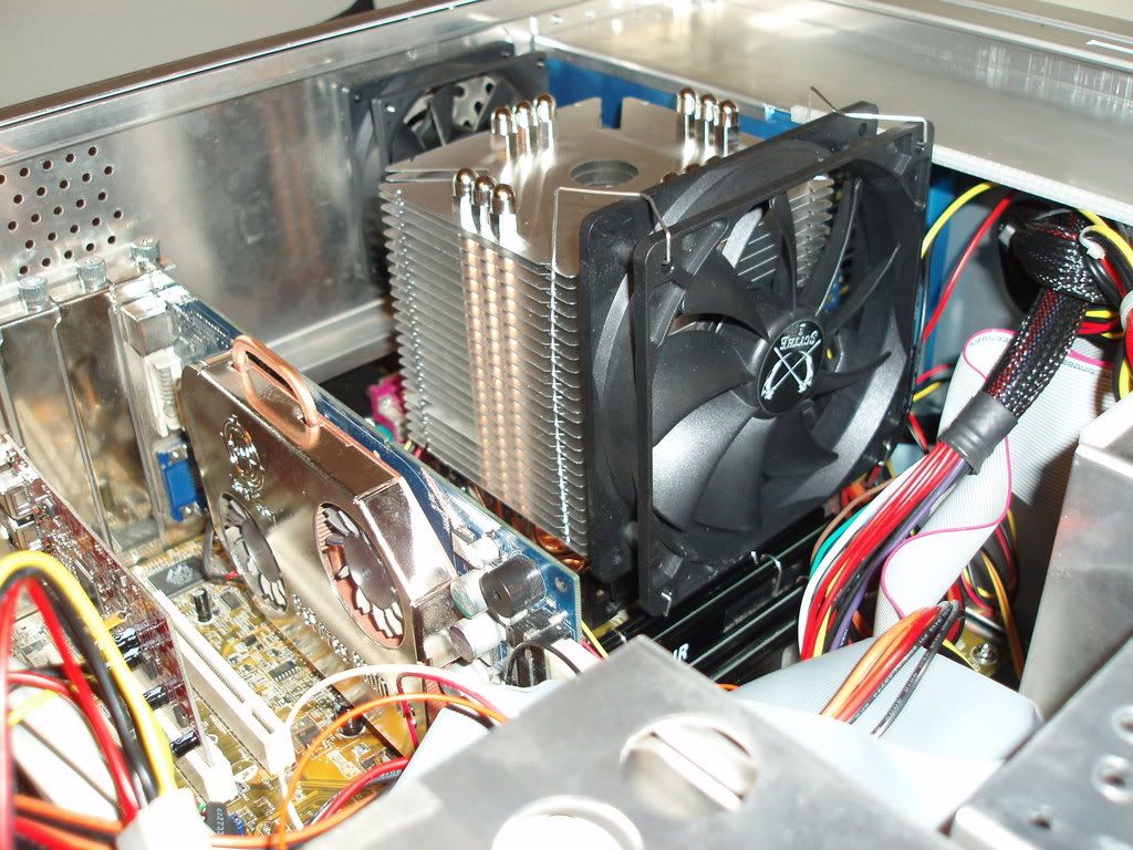

Well, I got it installed today. It still seems a bit hot, though. I think I will add the 130mm fan to either the side or the top panel. There is not quite enough room under the existing rear fan for another... At lease I can hear myself think again! :D I'll upload the pics next...

Before and after:

Before and after:

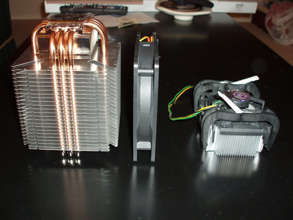

The heatsinks/fans size comparison:
Cleaning the processor:
Almost touches the side panel!

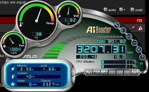

Wierd, the Asus app shows much cool temps... anyone else find similar experiences?
37C vs. 60C... I am apt to believe the app from the mobo mfg... but SpeedFan has always served me well on other PCs...:confused:
Damn that new cooler is huge, lol. A little wire management for better air flow and your should a little drop in temp. Switch out those regular IDE cables for rounded cables or make it to where they do not interfere with air flow.
I plan on changing out the IDE cables soon, I know it will help.

The inconsistency between the two software apps is my only concern right now...

there is either something wrong with the temp monitor, or something wrong with the cool. The ninja can do a whole lot better than 60c.
I never had any trouble from either ASUS' or ABIT's hardware monitor utilities from my socket 478 rigs,
so I would go with that. My last 478 setup was almost identical to yours there, and I was using a

I would defer to the ASUS temperature. To verify this, use a throttle watch program to see if temperature is exceeding the manufacturer's maximum.
