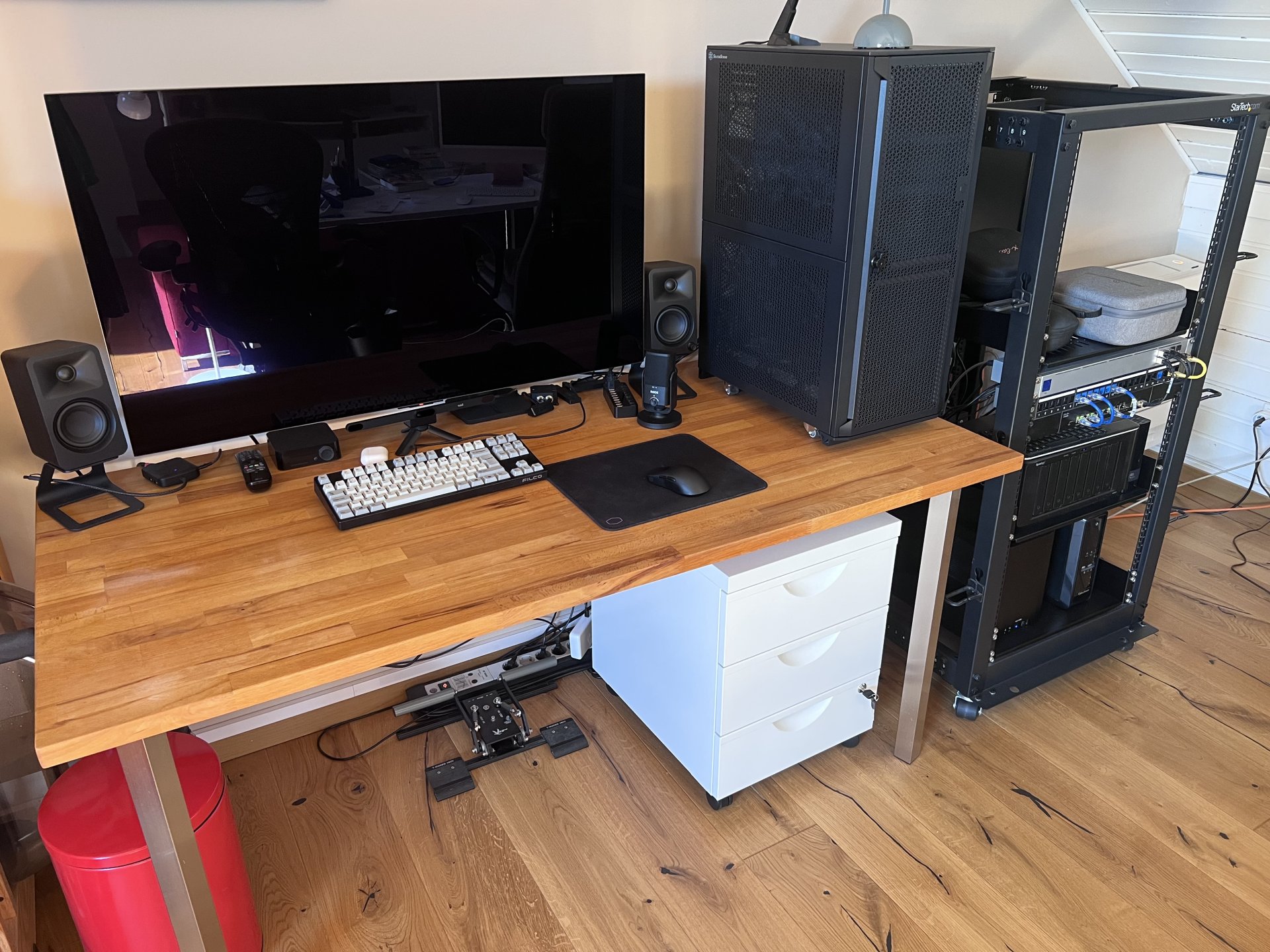

I went with that case. Overall i am very happy with it. It’s higher than deep which is good for desk space. The build quality is very good. The airflow is very good as well. Everything is made of metal and feels sturdy. The removable MB tray is also a plus.
I have a 1600w PSU so it’s enough but I needed 9 pci slots (and not 8 as I said in the OP) since on the x870 Taichi, the second pci port is in position 7 and 3090 FE is 3 slots more.
I could fit both GPU (5080 suprim above) nicely with some room below to fit 3 intake fans.
Overall temps seem good: 9800x3d cooled by Noctua d15s (2 fans @ max 80%) is in the 75-80C in cinebench and the 5080 does not go beyond 68C with the build being remaining quite silent. I had bearing noise issues with the rear fan (Vista 140mm) at certain speeds but the front 180mm fand (184i penetrator) are silent and perform very well.

Better late than never:
Silverstone Alta D1
Seasonic prime 1600W Noctua edtion
X870e Taichi 9800 X3D
Noctua NH-D15S Chromax
WD SN850x 2TB x2
RTX 3090 FE
RTX 5090 suprim
