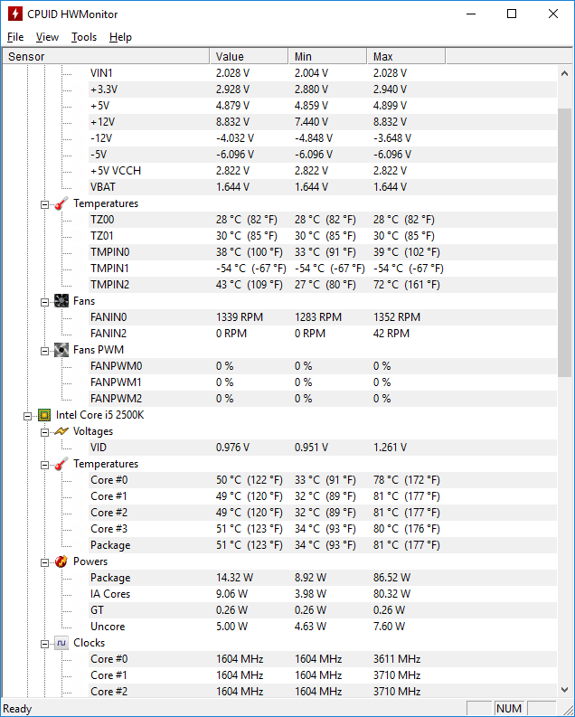

I just logged in to ask almost the exact same question (I have a i5-2500k as well). This is my first liquid cooled build and I just noticed my temps were really high. It is the summer and my room can get very hot (75-80F) but I wouldn't think it would account for the temps I"m getting. I am sitting at 40-45 idle and after about 30 sec of prime95 i'm in the mid 80s. I'm using a Asetek 570LX with CoolerMaster Thermal Fusion 400. Would reapplying thermal paste really drop my load temps by 20 degrees?
EDIT: Hit submit early on accident. CPU is running at 4.2GHz.
that sounds too hot, my xigmatek air cooler is maintaining 76c max during prime95 @4.2ghz and 1.304 vcore max under load.
What is your vcore under load? Either your vcore is high or maybe the thermal paste needs good re-applying
Also, I found the old thermal paste from the initial install...I'm assuming that stuff doesn't expire?
Your cpu core voltage looks great, much lower than mine. Your idle cpu temps and motherboard temps are high. How many case fans do you have?
Two front 120mm (or 140, can't remember), side panel 240mm, top panel 240mm, rear 120mm. All stock.

So after reviewing my screenshot I noticed my vcore was way too high. At some point I my bios must have been reset and I only went back and adjusted the multiplier and left the vcore as auto. Adjusted the vcore to .020 and reran the test and got much better results. Those max temps were seen at 15 minutes in Prime95. The test generally hovered right around 75C. I admittedly had this PC built (and OC'd) for me during the 2012 Verizon strike and is my first step overclocked PC. If anyone could chime in on the idle temps and temps under load it would be greatly appreciated. Or a sticky/guide I can read through. I'm afraid to go digging through google and learn incorrect information because someone thinks he knows what he is doing (like me right here with my vcore set to auto) and posts an article on the subject.
I'm having difficulty getting it to not stay auto. I can set the manual offset, save, then reboot and it still does auto. I'll try to do some more research tonight. There must be a setting him not hitting in my bios to keep the manually set vcore.
that's firstly because that application isn't reading voltages correctly. everything is absolutely wrong with the readings, 12v = 8.8 with peaks at 7.4? it shouldn't even POST the machine, -5V? that isn't even used anymore since years ago it shouldn't be used in your machine and is reported at 6.09V, also both +5 and +3.3 are way below of what they should be, battery voltage at 1.64V?..
so, with all of this, I would highly recommend the use of another application for take temps and voltage readings, you may use Aida64 which in the free trial will work with everything needed oh well.. just to be sure if you know how and have a multi-meter read the voltages manually.
Start there and redo everything..
The i5 2500K overcloking should be actually extremely easy and shouldn't require to mess with lot of settings in BIOS.. set manual CPU voltage at 1.300V and see how much high you can reach with the multiplier.. start at 44 if everything stable then go to 45, if everything stable go to 46.. then after this and find what's the highest multiplier stable at that voltage we can start to toy with the offset voltage and LLC settings... 1.3v should be good for anywhere near 4.5 and 4.7 depending on how lucky is the chip in the silicon lottery..
Be sure to set ALL cores to synchronized at the same multiplier (typical mistake honestly). or better yet.. post some pictures of your whole BIOS. (after reset) so we can see how is at stock and tell you what to change to find optimal results

I think you have a BIOS problem there, did you check if you have a BIOS update?.. it shouldn't say 0.00V because that mean the CPU is running at 0.00V in BIOS, that voltage in the picture (1.355) is the voltage that is actually applied to the CPU, generally there isn't any C state enabled(power saving features) and some boards apply the Vdroop calibration method (MSI as one of the worst examples to utilize this method) so the voltage in BIOS may show higher than what actually could be under load.. also some boards depending on the model apply voltage is through VID request instead of a fully manual or offset voltages, so, sometimes it require to see what's the CPU VID at the moment of the load test and then make adjustment from there.
Use CPU-Z for an accurate CPU voltage readings, for now ignore the VID but remember those old non-UEFI BIOS require to utilize +/- on the keyboard to add/subtract instead of the numeric keypad to add a direct manual number, when most people talk about a manual voltage meant it's fixed non-variable.
I am running the newest BIOS however that was from 2006. The mobo was originally a non UEFI and then updated to UEFI IIRC. The numeric keypad works and I use the page up/dn to add/subtract. Another odd item I've seen (not sure if related or not) is my CPU speed shows at 5.4Ghz in Windows (even after clean installs). Would it be worth trying to reflash the BIOS? If it is a cosmetic issue it doesn't bother me.
CPU-Z shows it running at 4.2GHz. It was just weird Windows showed it as something different let alone a ridiculous number. I am assuming my CMOS is still ok since it will save the CPU multiplier and the RAM overclock speed. Real Temp GT is new to me, I'll pick that up when I get home. Only 2 1/2 more hours to go.

I found the solution to my issue. CPUID, HWMonitor, AIDA64 all show my core voltage wrong. The CPUID inside AIDA64 did show the voltage correct. DVID worked as it should. It just appeared that it wasn't since the other programs did not show the correct voltage. Now running 4.5GHz at 1.31V. Hopefully this will save someone else some trouble.
