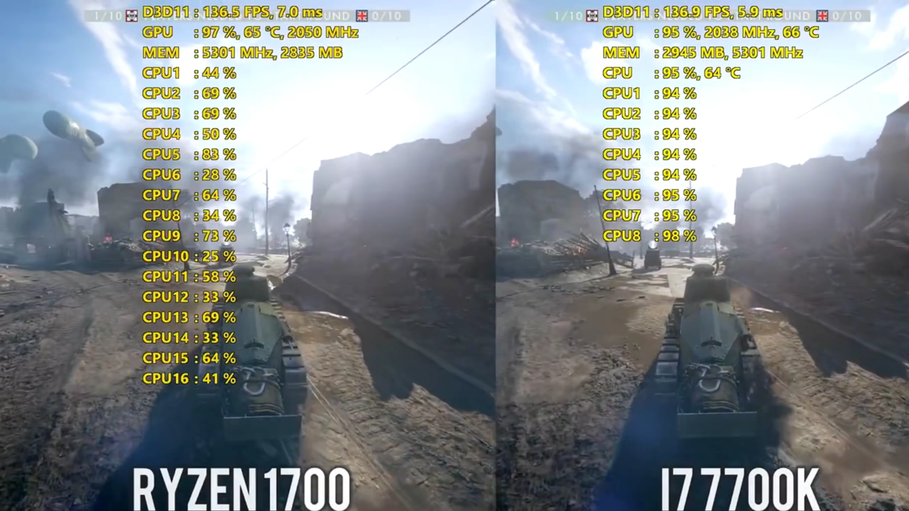

Food for thoughts about the Ryzen tests:
The guy has back-tracked AMD FX lineup tests over the years proving that low resolution tests give unrealistic advantage to cheaper processors rather than getting rid of GPU bottleneck. i5's should be nowhere near the gaming performance of Ryzen 7 after the bioses are optimized and your system has realistic software configuration with background communicators, web browser and productivity apps opened.
He also noted the fact that Ryzen 1700 was bottlenecked by GPU in Battlefield 1 benchmarks against the 7700K which is clearly visible in this screenshot:
