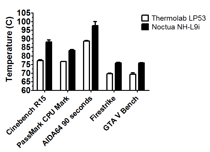

Here's some quick results. I'll add more details and comments tomorrow
So far this is just the data from the i7-4790K at stock, 4.0-4.4ghz, 88W. Each test was run 3 times and the average core temperature recorded for each run. These averages from each run are what make up the bars on the graph. It seems the lp53 came in anywhere from 5-11C cooler in every test.

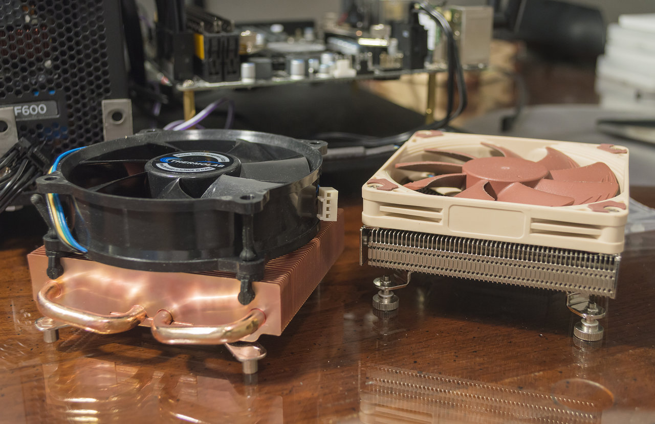

Also it should be noted that the lp53 does fit parallel with the ram. It clears the vrm on my Ga-z97n-wifi by about 1.5mm. That seemed to improve temps about another 2C though the same would be true of the noctua too.
Is the LP53 a lot louder ?
I'm using the noctua fan otherwise it won't fit so, volume of noise is similar but the sound itself is slightly different.

The lp53 is significantly better than the nh-l9i. After testing the lp53 I can't recommend the nh-l9i for K series Cpu's anymore. The noctua nf-a9x14 fan brings the lp53 down to an acceptable height and it can be purchased by itself for ~$15.
If you have a 65w locked cpu you'll be fine with the nh-l9i, unless you want an overkill cooler.

The noctua fan already overhangs the cooler by a bit. If you could figure out how to attach a larger fan, I suppose it'd help. I've yet to find many other fans as consistently quiet as noctua so it's up to you. I have 120mm noctua fans I could try. They're too tall for sentry but it'd indicate whether or not a slim 120 that pushes more sir would be worth it.

I originally zip-tied it to the heat pipes which stick out quite a bit from the main body of the cooler, but ultimately just decided to use rubber bands as the zip ties kept slipping.

I realized I never really posted a summary of the LP53 results here.
In a comparison with the ever popular Noctua NH-L9i, the Thermolab LP53 performs 6-10C better in all tests when using the Noctua NF-a9x14 fan from the noctua cooler. I did not test it with the stock fan pictured above as it will not fit in sentry with that fan.
I don't think the lp53 is necessary for 65W cpu's unless you are obsessed with temperatures. It is however a much better option for unlocked cpu's 77W and above. During normal gaming, at 18C ambient, in an open air setup my i7-4790K (88W, stock, no OC) with the LP53 stayed at 74C or below in even taxing games like GTA V, Cities Skylines, and insanely modded Skyrim. Previously with the Noctua it would reach the 80+C mark in such games.
