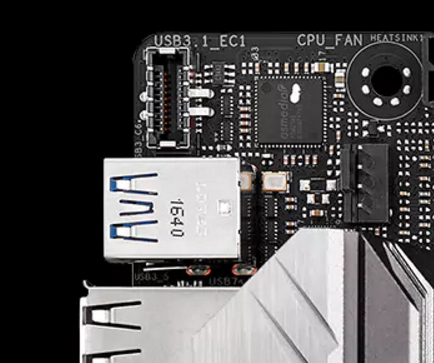

Is it possible to replace 3.0 usb with usb 3.1 front panel cable? It could be an additional cable or even buying option due to increasing popularity of 3.1 usb.

It's just a cable with another header. There's no need to change something in the case. But it will make sentry stay up-to-date longer.
At this point not really.
First of all that type of onboard internal connector is not yet a standard and we'd have problem with backward compatibility of this. We've had similar problem when USB 3.0 20pin header wasn't yet in all motherboards and we tried getting backward compatible headers or adapters for 2.0 and for the most part those were quite expensive. We've dropped this support thanks to USB 3.0 20pin being widely implemented in all boards starting with skylake.
Secondly there's no such connector cable like the one we're using at this point and we're definitely won't be making such huge last minute changes just to fit type C connector on the front panel.
We're supporting reference USB 1.1/2.0 dual port bracket cable that is 60mm wide with 47mm mounting hole spacing. There are still USB 3.0 cables in this format and we're including such as a front panel. I think that when the 3.1 connector gets mainstream, we may see a combo dual port connector in this format with type A + type C. When that happens, you'll be able to upgrade your front panel to type C.
Not really. Type C connector has different shape so we'd either have to leave the front panel holes for rectangular type A and make it look really bad with different shape of connector inside or change the shape of the hole which would make the case front look slightly differently. And there's of course a lot of boards that don't have this type of connector in which case they couldn't use front panel ports with usb 3.0 or 2.0 if we've changed the shape of hole.
Finally the Type C is a smaller connector and most likely has smaller connector clearance than type A. Type A let's you have more than 2mm of distance between the connector face and extern of the chassis because the connector is quite big itself. We've got two layers of 1mm thick steel making up the front of the case where the USB front panel is mounted. If we were to use only one layer of metal, the front wouldn't have the screws flushed in elegantly like it is now and there would be additional structural integrity problems with psu mount because of that single piece being cut just so the usb type C would be closer to the external surface of the front panel.
TL;DR - it's not that simple.
If you can find such dual port connector that is matching our spec on ebay or aliexpress then I'd like to know where to get this to try sourcing it at least for a reference to the others.

Ok, maybe you're right. But it will be hard to replace, if sentry usb front panel mounted with glue or rivets.
if they are using standard panel mount usb port(which it sounds like in the above post) then they will be screwed in or bolted as the socket is threaded.
We're using literally this (but completely blue):
This is easy to mount to the front panel and its screws make up for the part of aesthetic of case.
Currently type C+A combo front panels look like this:
I think it is possible to make a metal adapter for this type of front panel to replace the front panel of Sentry.
You can simply cut down this metal piece visible in the photo around to fit inside the case. You'll need to add two threaded bushings on the sides with 47mm distance first so you can screw that to the front of the case or you can look for another method of adding a thread to this like simply tightening an M3 nut with some glue on the other side of the holes.
I'm not entirely sure if the Type C port will be ideally in center of the rectangular hole.
If you find some front panel with this new connector type, then let me know :)

Thanks for a clear explanation. In my opinion usb type C like a micro usb suits only for a mobile devices and there's no point to use it in desktop pcs. As I see, it will be surely possible in near future to buy cable like you use in sentry but with odd 3.1 usb header and two usb 3.1 type A ports and easily plug it into senrtry case.
