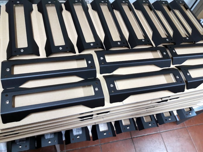

At this moment we are working on assembling accessory boxes for 5th transport. By the end of this week we should be able to start preparations for another packaging process.

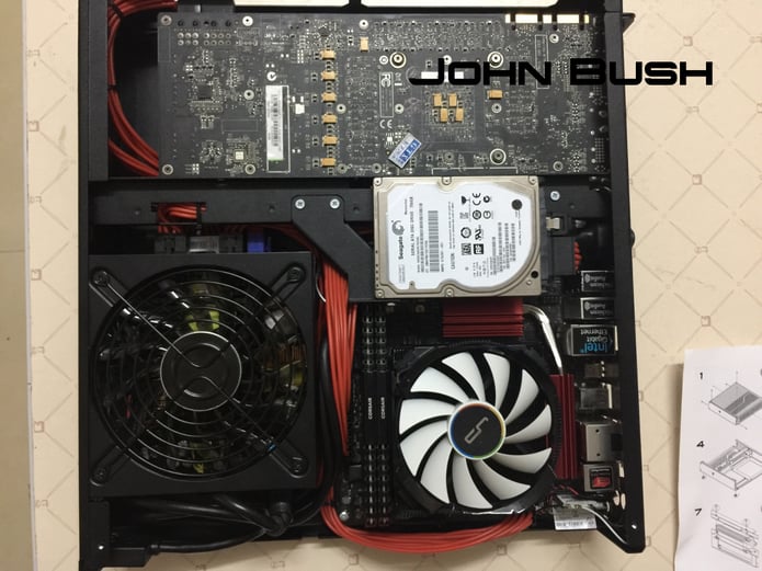

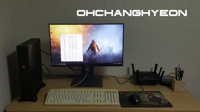

As a bonus to this update we are adding some photos sent by our supporters showing their nice PCs assembled inside Sentry. As usual you will find more in our forum topics.

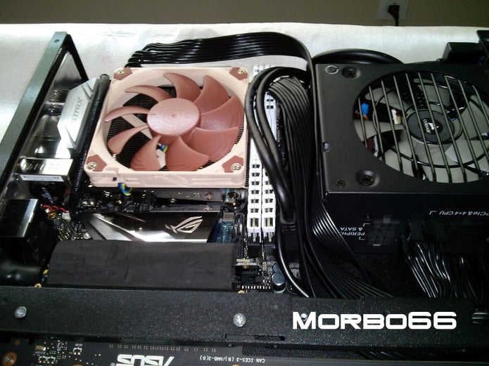

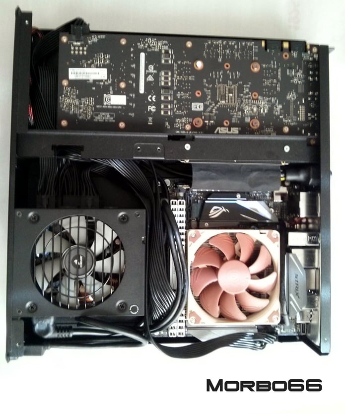

I noticed that everyone uses the NH L9 in the same orientation (openings towards ram and connectors). Isn't it smarter to turn it by 90° so the hot air can escape?
Reactions: Ej24
Bingo, tho impossible with noctua supplied AM4 brackets.
Really? I was unaware of this. What about the actual amd compatible nh-l9a? Does it allow for proper orientation with fins parallel to the ram?
No, the fins direct air in the same direction. Also, with the l9a, not even a custom bracket would be able to help as it is longer than the l9i to fill the rectangular keep out zone on amd boards.
Seems like a major oversight by Noctua. I realize not every case has this layout but to have 1/2 the exhaust against the ram and the other 1/2 against the rear i/o doesn't work well in any case.
Reactions: RosaJ
Can't speak for others, but I didn't even notice it when i put on the cooler. Was too busy worrying about routing cables, so mine is in the bad horizontal orientation with opening towards ram due to not paying attention and not on purpose. hah
Although to be honest, it might only make a few degrees difference in the long run. I finally got windows installed, and still need to install Steam so if it becomes a problem, i[ll re-install the Noctua with the fin opening in the vertical orientation.
