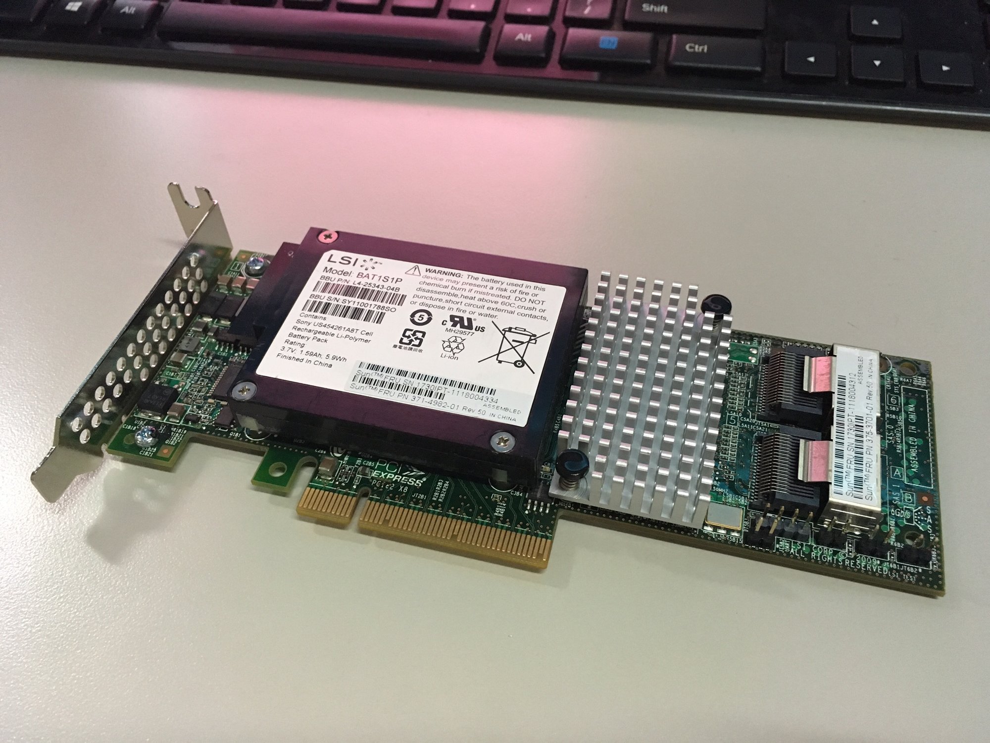

I have this card that I was going to use for my media server eventually, but haven't gotten around to it since I need to have a bunch of empty disks since I believe all the drives attached to this controller need to be configured in the card first.
Which means my current drives with data would need to be formatted if used with this controller.

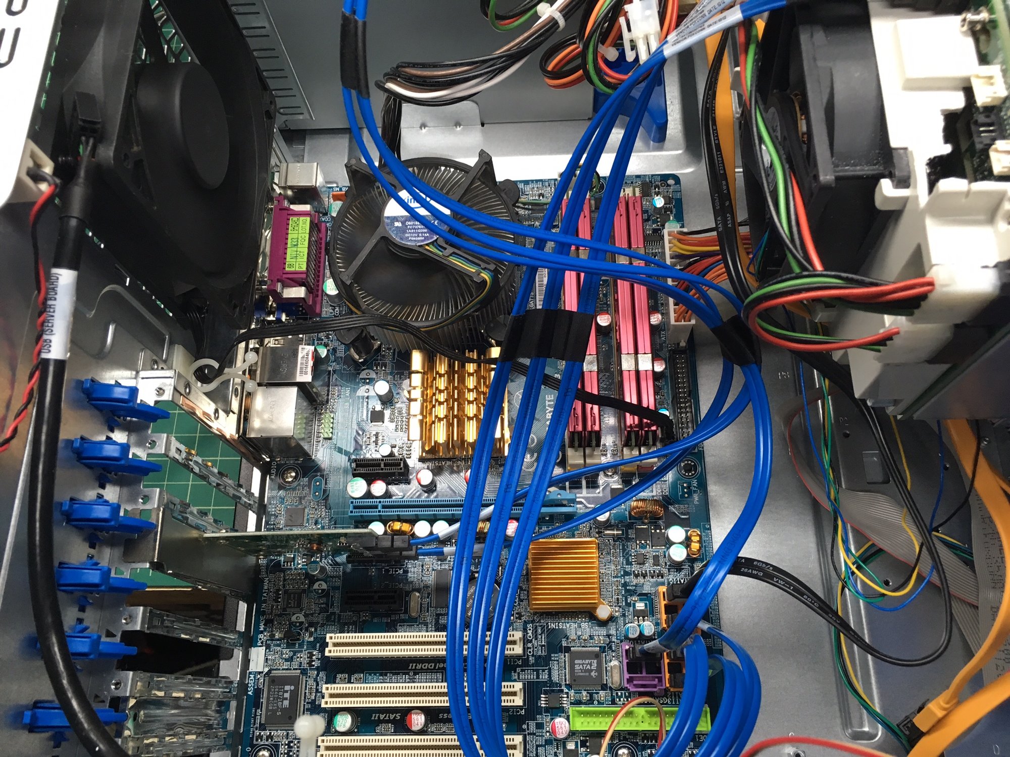

I do have a few HBA's, which are just SATA ports on a PCIe card, and those allow you to plug in a drive with data on it and use it in windows as is.
Was using one when my Plex server was in an old Core2Duo machine,

Is that standard with the top SAS card that you have to format the drives. That would be a problem for me. I have used similar ones to the bottom picture. I may just go that route but I remember the speed was like 30mb/s transferring files.

The first picture he posted is a LSI-based SAS RAID card or HBA, and assuming it's in RAID mode yes, you would need to format the drives. Assuming you are able to format the drives, this is the best way to go (in my opinion) because you get hardware RAID support.
The second picture he posted looks like a generic PCIe-based SATA controller, which should have performance roughly similar to your onboard SATA ports. If it's dramatically lower, like 30 mb/s, then you've got some other limiting factor.

If I have no use for hardware raid. Is the SAS card necessary?
I actually still have a 2 port pcie sata card. I'll fire it up and test it out.
If you don't want the RAID, then a regular HBA or SATA controller card should work.

I don't have much experience with the card, it's an LSI SAS Raid card, but when I was testing it out with a 500GB Sata drive, I had to do some initialization thing in the software before the drive was recognized by Windows.
