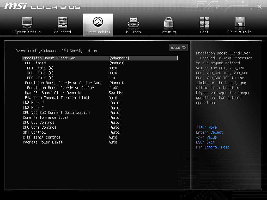

Here is a tweak for a few more FPS for your Ryzen CPU. With your mother board,this will give more CPU clock,adjust EDC and test and always at your own risk.I game at 4k but I like the free extra FPS.Here is an example below BF5 at 1080 for example,did at 1080 for nut bars who only think 720/1080 is the only way to test CPU.
Also at 2560x1440 adjust /tune ram timings and your good to go for best results,does not matter if you run DDR4 4200Mhz ram or DDR4 2133Mhz ram.I will also add video for 2933Mhz vs 3866Mhz Ram
so your 3600Mhz is fine,just tune timings.
PBO limits to manual
PPT limit =0
TDC limit =0
EDC limit =1
precision boost overdrive scalar - manual =10x
max cpu boost clock override =200mhz

put EDC to 11 - 15. dont do "1" like post above said, your single thread performance WILL TANK
This is not true if you know what you are doing,can some EDC values with Windows power plans not work 100% at times with single thread or multi thread,why yes that is true.OP can test any value he want's like I suggested
I never understood why a lower value gives better performance that the Motherboard value which is 280A on my board. Can you enlighten me or point me to an article?
IT is a Bug in BIOS ,which has been around since at least July/August from what I remember and used,here is a thread with some information and different motherboards and CPU 's suggestions.
https://www.overclock.net/forum/13-amd-general/1741052-edc-1-pbo-turbo-boost.html

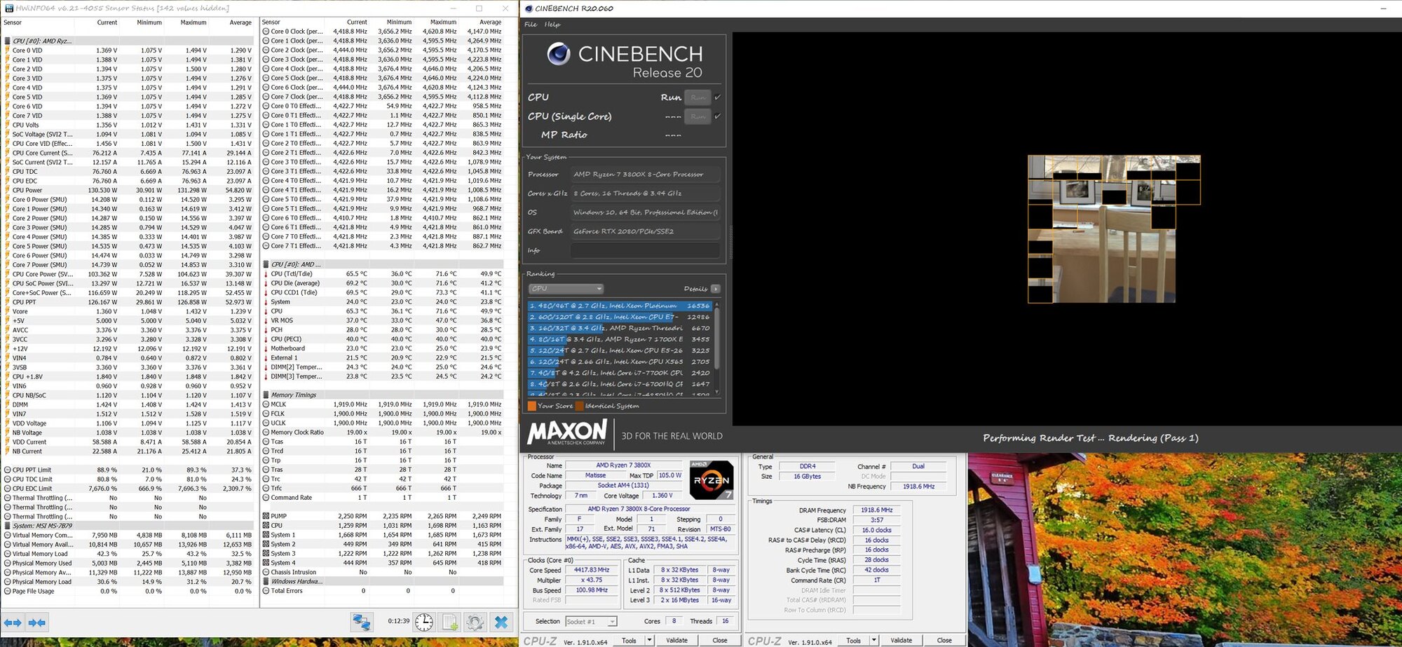

Well with tweak I can get 4400+Mhz all core Cinebench20 no problems,tweak works fine for me.In single thread and multi.It is worth a try if someone wants an extra 100Mhz + on CPU clocks.
49462447431_e5fb86e65e_k.jpg4400-Cinbench20

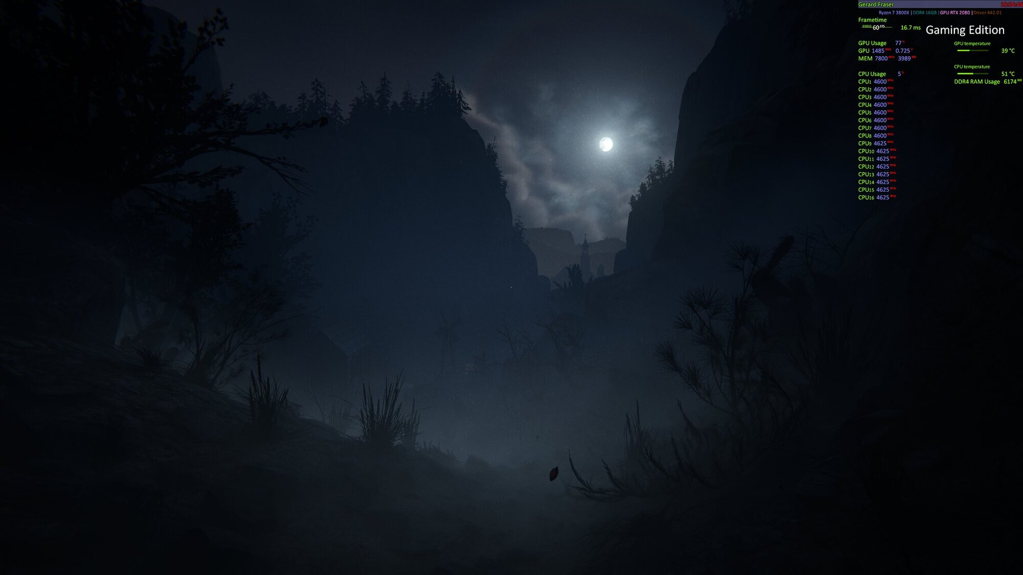

Video:Highest normal Boost is still 4650Mhz. With 4600Mhz average boost clock
3800X light gaming
AMD 3800X Bclk 4700Mhz+

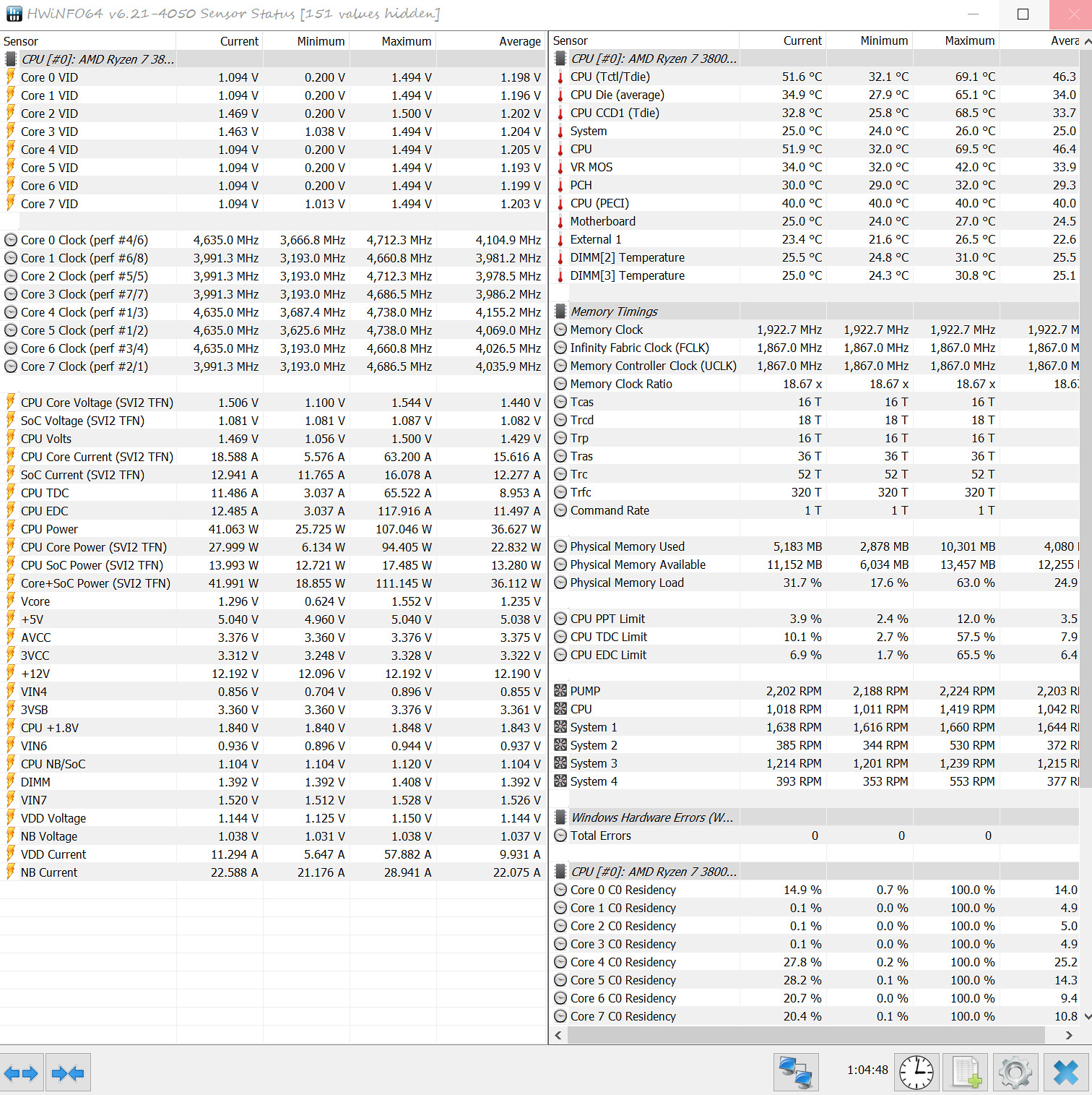

My 3800x just setting EDC 1 in BIOS and scaler 10x and nothing else Cinebench20 still 530 score with Ultimate power plan but power saver plans I have seen 478.Try it out if you want or anyone.I suggest back to back runs.
This screen shot is not the highest or even average for my 3800x,so I guess I would have to agree with single scores are low.
Here is a screen grab of a youtube video I did in cinebench20 in 2019.
