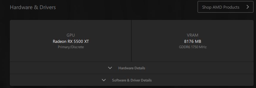

zahf.JPGAnd amd radeon software shows me that I have 8176 mb vram instead of 8192 mb.za hf2.JPG

Here look at the hw info, but I still have a problem that my memory on the gpu works at a lower frequency, the game goes up to 1740MHz.
