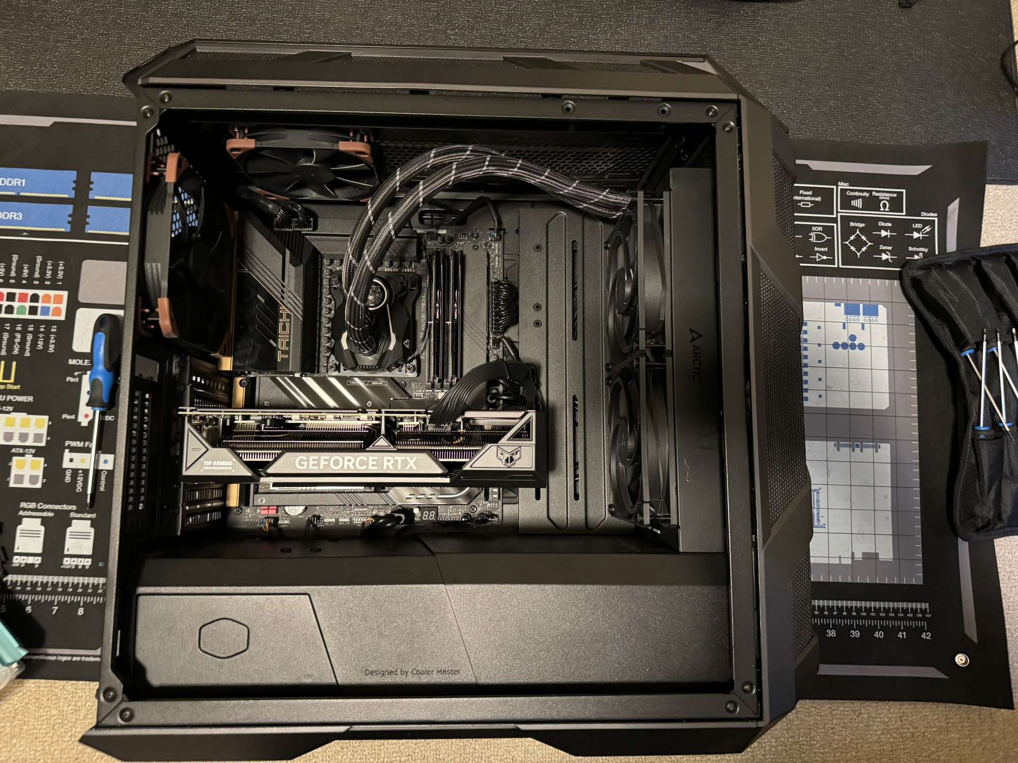

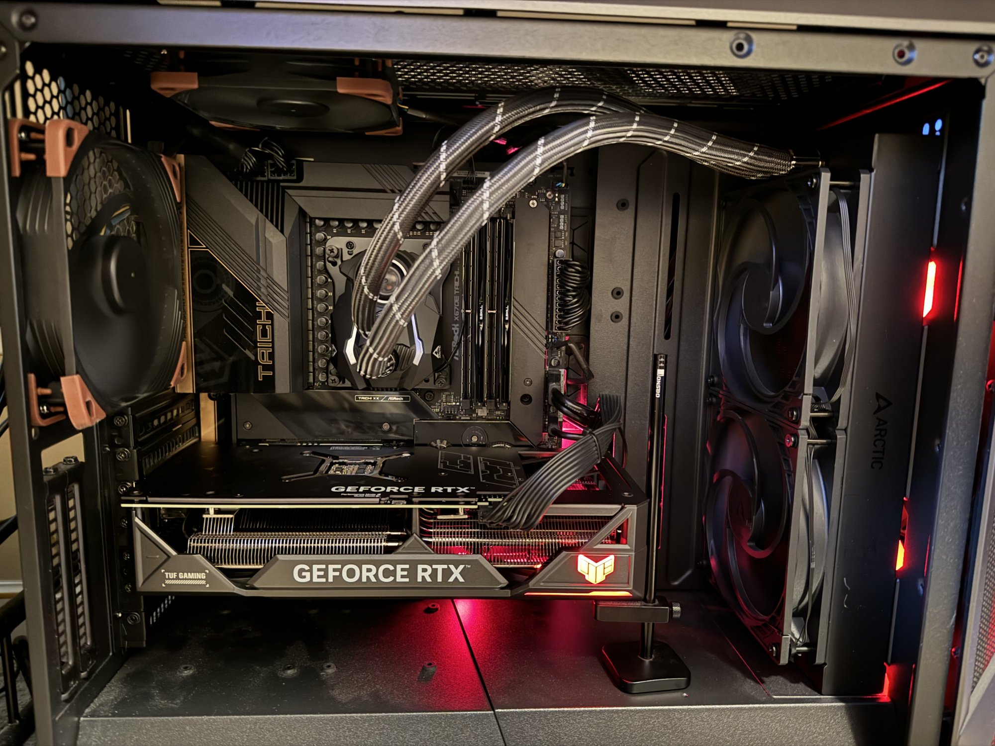

Thanks for reading - here is a couple build pr0n shots in addition to all the VRel stats:
