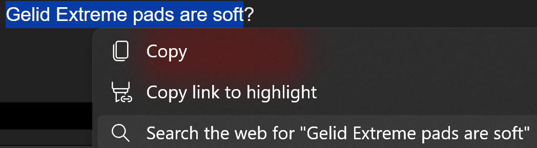

I see. Do you know if those Gelid Extreme pads are soft?

Gelid:
Thanks to its softness and ultimate thermal conductivity the GP-Extreme fills spaces properly and offers the best performance in class. Gelid Thermal Pads are non-electrical conductive, non-corrosive, non-curing, and non-toxic.
Few links later:
The Gelid GP-Extreme pads are both relatively stiff and require significant compression to perform best or reach rated thermal conductivity
So yeah, looks like softness/stiffness is relative. Was hoping for first hand experience :)
