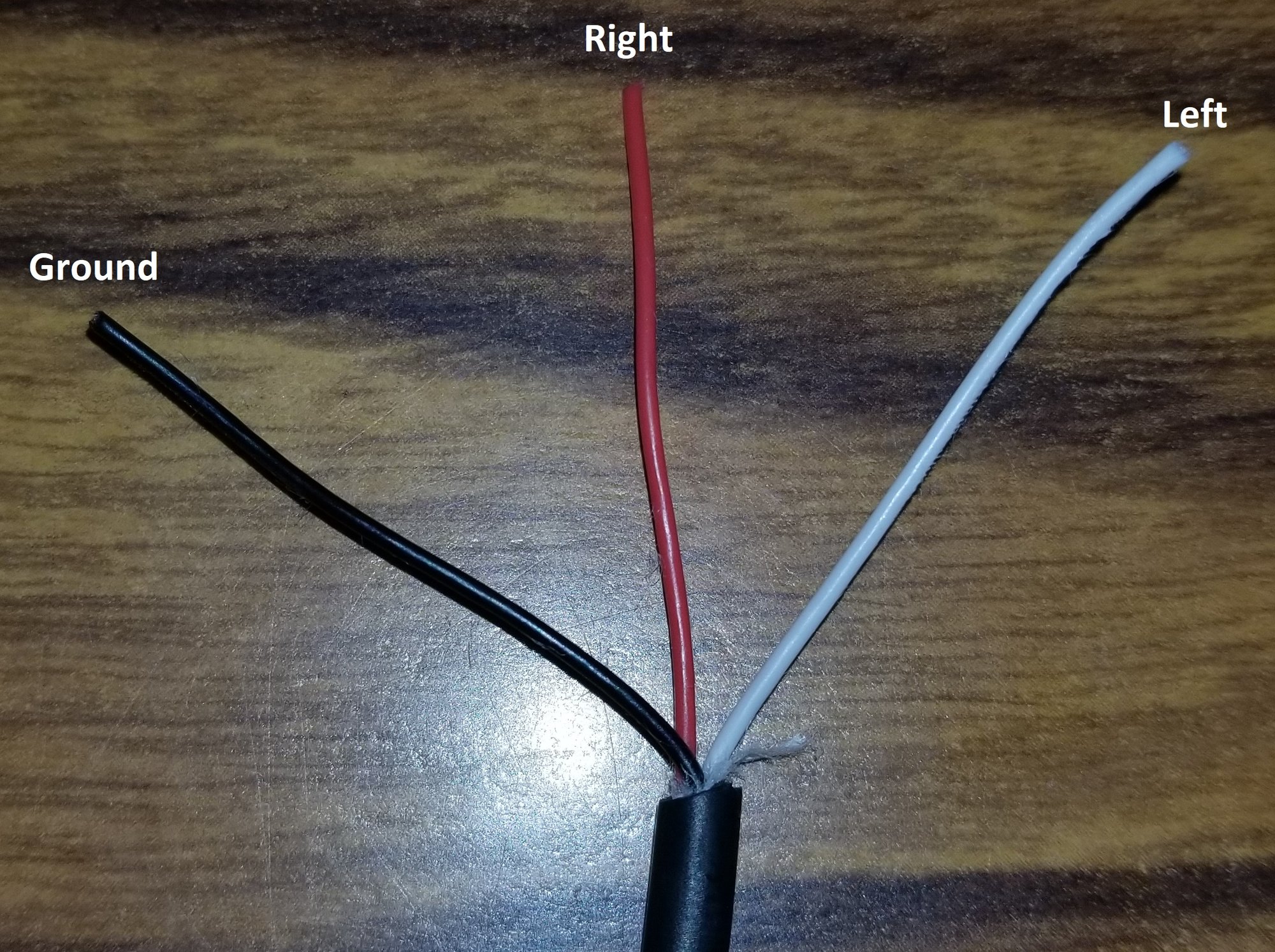

I did a little investigation while waiting for the replacement plug to come in. Disassembly was pretty easy, the only thing that I'm not sure of is which wires do what? I think that they are as follows?

that's the standard color coding as far as I know. good thing you got that receipt though, ya never know when you might need it! ;)
