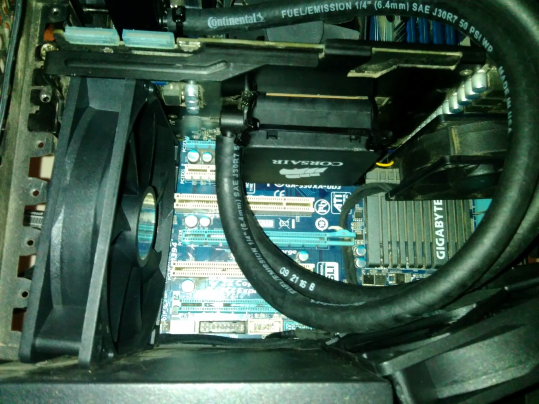

you can use either or and it will prevent corrosion or dw and ptnuke. but I think that is not really as big of a deal as people make out. cars engine run under way higher temps and with more mixed metal than an aio and they are good for how long?! as far as replacement tubes and filling I would recommend a t and fill line you can cap off/plug. you can do it without like I did but its trickier. for tubing I'm currently using continental 6.4mm fuel line(if barbed rads). its very flexible, chem resistant, kink resistant, reinforced and rated for a high enough temp. I can literally double it over on itself 180 and it does not kink. if you don't want the white writing it comes off with a scotch brite pad.
ps: if the aios pumps still run but they don't cooler properly then there is a clog in one of the barbs and it could/should be fixable. that's how I got my h60 pic'd above :)
