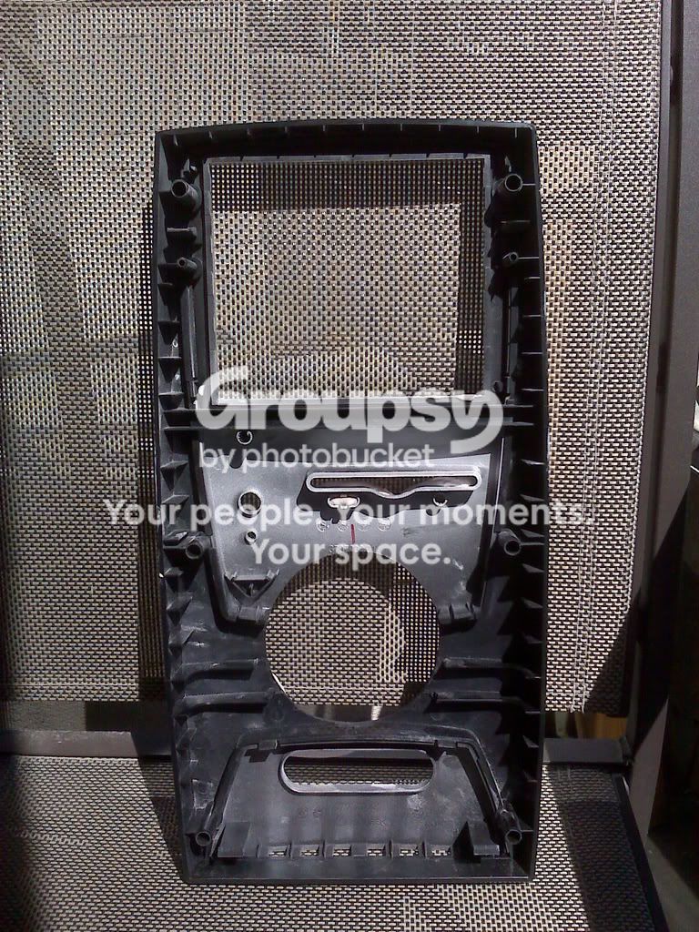

I hated the front of this thing, except for the little recessed usb mic/speaker panel, so I had to figure out how I was going to work this thing together. I don't have all the pics, but I can tell you that I:
- epoxied the silver and black pieces together (they were all actually snap-together separate pieces)
- busted out mr. dremel and after some quick measurements, cut a hole in front of the case... what diameter you ask? Why the diameter of a performance-pcs fan duct, of course!
- I also started to build up a little bondo around the vent hole (and filling in the a drive hole), as it was a curved front, and the fan duct had a flat mounting area
and here's the glorious backside of it:
Not looking all that impressive as of yet, granted, but I am hoping for a pretty clean finished project.
Next up: Bondo, bondo, sanding, sanding, sanding, priming... let the good times roll.

Test fit the duct in the bezel
I must say that the self-ethcing primer is awesome, evil paint. It has a heavy, coarse texture that for the most part, looks pretty damn nice... might even consider doing a case only in the primer.
Front bezel is coming along nicely... there's a little more bondo on there, and I think that once I have the red on there, it looks like there may be some visible seams. I'll do a test coat or two, and decide from there.
Ah yes, the inside frame of the beast... Super sexy with that crudely dremelled hole in it, no? That's, of course, where the fan will be mounted. Because I'll be mounting the HDD in the 5 1/4 cage, I just tossed the HDD cage. A quick cleaning and spray with Tremclad black should suffice.

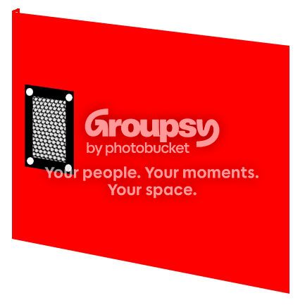

Okay. Figured out a way around dealing with the pre-existing indented ventillation things on the sides of the case. As the front duct is going to be modder's meshed (hex mesh), the front is going to be both black (from the duct, bay covers, dvd-rom, and the front panel socket plate), red, and meshed.
The sides were originally going to be red. That's it. Hardly [H]ard.
So, I am going to dremel those offensive areas right out of the sides of the case, modder's mesh 'em, frame them with something, and bolt the frames to the sides. Should provide a nice consistency across all sides of the box, and should look a little like this (pardon crude Paint drawing):
Plus I can get rid of the hunks of bondo currently filling the indents (and the distortion in the final paint will be gone from the uneven areas).
Best advice I recieved thus far: Filling primer. Genius. Thanks, Arcy. The front panel has had bondo reapplied, solidly, and is in the process of being primed with the filler primer. It seems to be eliminating any imperfections in the bondo levelling entirely. Pics to come soon.
Okay... vents cut out (several dremel cutting wheels later), and all of the unsightly bondo is gone! I had modder's mesh, nuts, bolts, etc... but i needed something to frame the grill. I found some crazy stuff that looks like unprinted circuit board - kind of a thin plasticky particle board type thing with a thin layer of copper foil on one side. As it turns out, it happened to be exactly the right size in one dimension, so I cut it up and dremelled it out, and sprayed it black...
I then added the modder's mesh, a piece of nylon window screening to assist with keeping dust out, drilled some holes, and here's a mock-up of what the final side panel vent should look like... what do you think?
