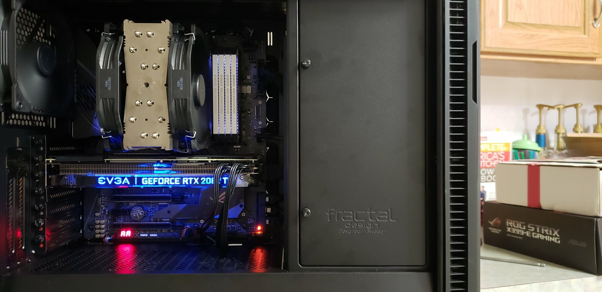

Hello I am interested in similar x399 build with Noctua U14S cooler. I see you have 8x8GB RAM config, did you face any issues with clearance for this large cooler, RAM sticks and first PCIE slot and did it affect your case and RAM choices
Yes, I did have problems with RAM height. The cooling unit fit, however the fans had to be raised a bit to get proper cooling. I did not add the coolers to the RAM. The image below should show tolerances.
Thank you. Those of us considering air cooling for TR4 are in minority and it is difficult to balance the configuration. Could you please edit you signature to give a complete picture of your build (RAM and speeds, cabinet).
