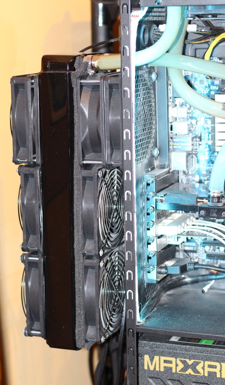

Top rad (480):
Rear rad (360):

Note that its probably a cheap fan cut out and not a cut out Typhoon as its two different fan casings. Cutting out a GT for a shroud is heresy!
Ya, I used a sacrificial failed Scythe Ultra Kaze fan which I gutted. Works surprisingly well as a rad mount. I'd never do that to a Typhoon though... If one ever failed on me (none ever has and it's been a good 5+ years now), I'd give it full honors and bury it in the back yard.
i assumed that. :) everyone knows(or should) that you don't double stack working fans.
gotta give it a little tombstone too!
