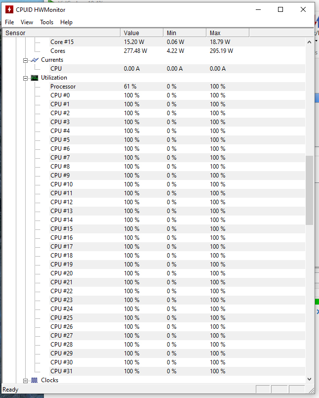

After 7 months since I installed the ProSiphon Elite, I have been able to push my Threadripper 1950X further than I ever thought I could. The numbers speak for themselves and what a performance increase I have been able to get. It took some tinkering with the voltages to get a stable overclock at 4.1GHz under constant load. I had to dial up the voltage to 1.43125V. I am encoding 4K MKV files at very high settings which taxes all cores of the processor around 100%, running for days constantly. Outputting an average of 340 watts with a temperature hovering around 84C isn't bad. By contrast, when I was cooling with the Noctua NH-U14S or the Silver Arrow TR4 I wasn't able to get more than a 3.8GHz stable overclock pushing no more than around 1.27V. Water cooling was never appealing to me but from what I've read, others are able to cool the Threadripper similarly to custom water loops with the ProSiphon.
Yeah looks like the consensus is coming out pretty clear on this; if you aren't going to dump at least ~300W into it, don't bother with this cooler as you can get better results for much cheaper with any of the usual big air contenders. If you *do* happen be pushing that much with a beefy HEDT chip though, it's actually a damn decent performer and might be worth a purchase if you for some reason don't want a big AIO, a full blown loop, and if it'll fit your build.
