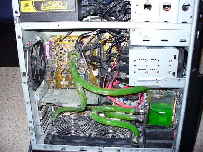

My current case isn't exactly "clean," let me show you what I mean...
So why the worklog? I will be swapping out all of the current hardware into a new case, slightly modifying the case, possibly lapping my cpu/waterblock, and setting up the watercooling. Sound a bit dull? Perhaps this isn't going to be the most exciting worklog but I will post as many pictures as I can in an attempt to make it interesting :). I plan on modding as much as I can, and making it as clean as possible (so if you have any suggestions let me hear them!).

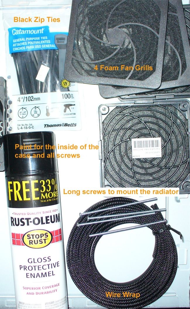

Here are a few things Ive picked up in preparation for this project:

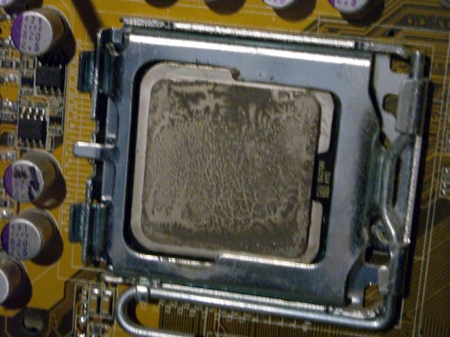

As I have said before, I definitely want to take my time with this project. Since watercooling is involved it would be hard to prepare the new case without having the radiator, res, pump, ect. out of my current case so I can do measurements and such on the new case (while still being able to use my computer). What does this all mean? For the first time ever my e6400 C2D is going to be air cooled!
Time to get out my never-used heatsink. I knew it would come in handy some time. :p
Say good bye to the water cooling!
Just in case anyone is wondering about specs/temps. My CPU is currently OCed to a moderate 2.8GHz. The left screenshot is watercooling at idle (both cores were at 33 the other day... kind of odd) and the right screenshot is the air heatsink that I just put in at idle (working better than expected).

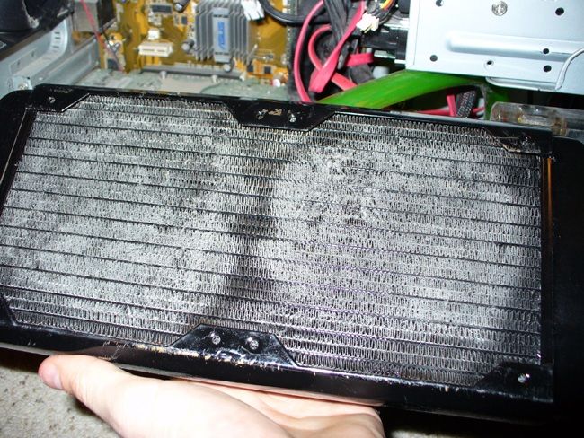

Looks like that case hasn't been opened/cleaned in 4 years ;)
*chases after the dust bunnies* :D
lol sadly it has. I try to clean it every 6-8 months. Unfortunately with the setup (with the radiator sitting on the bottom of the case) dust collected very easily. This is part of the reason why I am re-designing everything and using foam fan guards. Brb cleaning out my watercooling stuff :) Ill return with an update most likely tomorrow.

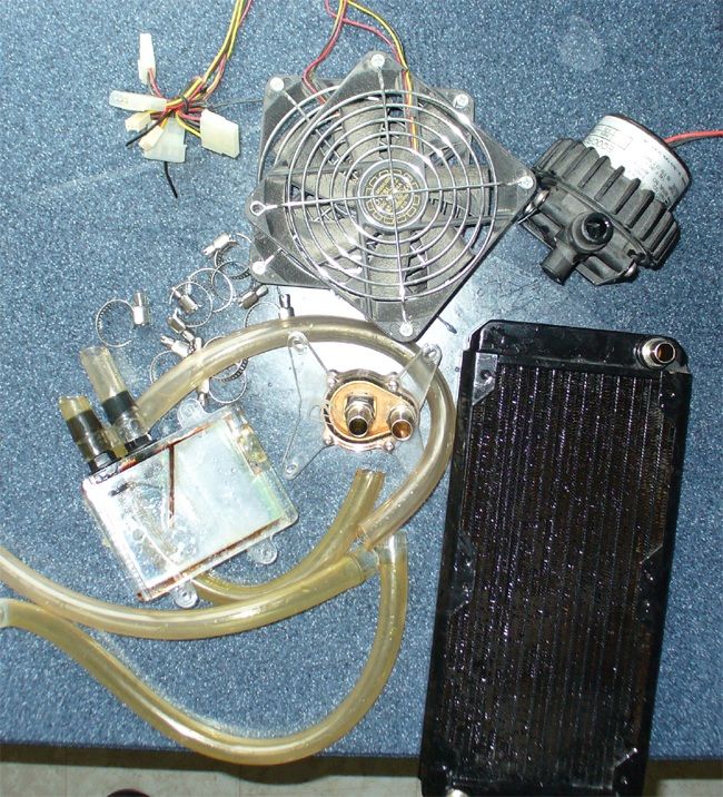

Took my watercooling loop apart, still have to clean everything:

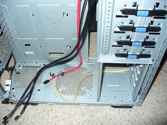

Now... where to place my pump and reservoir. I have 2 cd/dvd drives which will be put in the top two bays but Im going to attempt to put my pump and micro res under the 2nd optical drive. Im either going to use a 90 degree fitting for the outlet (since an optical drive will be RIGHT above it and I dont want to bend the tubing to such an extent) or I will have it hanging over halfway and just screw it in there.
Tomorrow I am going to put a drive in the 2nd bay and see how the pump fits. If it doesn't fit well I will most likely move the pump to the bottom of the case. Once I have the pump and res mounted I will then attempt to mount my radiator up top above the case (using long screws). Once everything is drill/mounted I will take everything out and do some spray painting :D My plan is to have just about everything in black.
If anyone has any suggestions as to where to mount my WC stuff im open to everything!

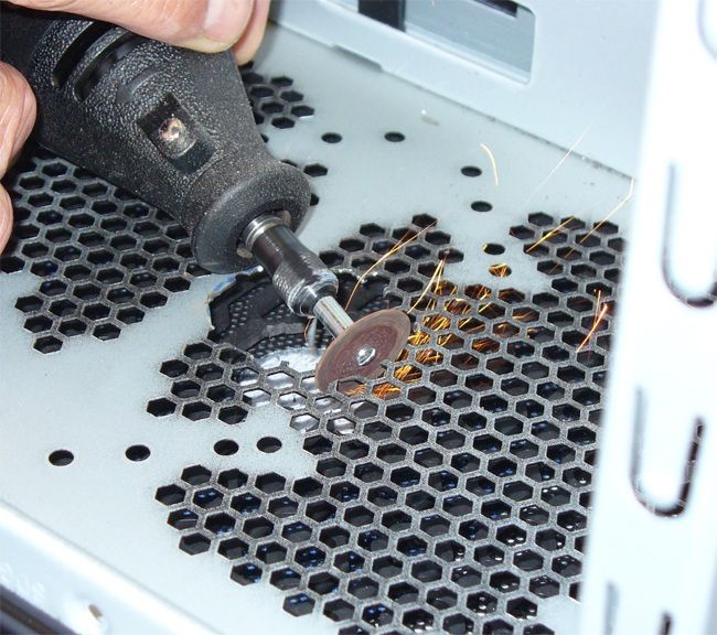

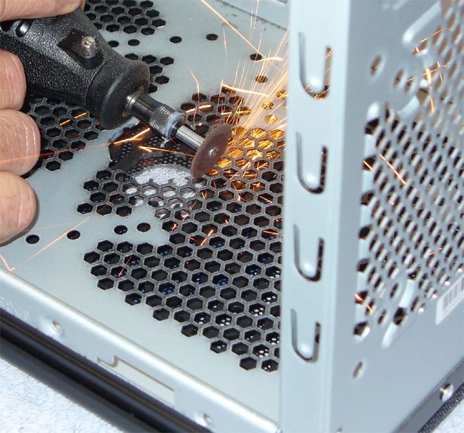

So I decided to use my new dremel and start cutting to mount the water cooling stuff.

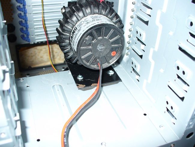

The pump and micro reservoir will fit perfectly under my second optical drive. I drilled two holes to have the pump mounted and the micro res will be mounted by velcro right next to it.

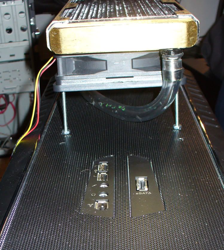

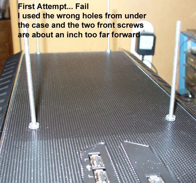

Now, drilling the holes for the radiator. For those of you who don't know, the CM 690 has two layers on top of the case. The first inner layer is a bunch of holes for fans to be mounted and the second layer is the part that is visible from the outside. Unfortunately I had a brain fart and used the pre-existing holes on the inside layer which were for 140mm fans (instead of 120mm). Ya... I drilled two extra holes in the top of my case... :(
Here is the top of the case, with the radiator mounted using the CORRECT screws. This was just a test to see if everything is in the right place.
I circled the two holes that I messed up. To fix this I am going to put a screw through the bottom and a nut on the top of the case to cover the hole. Everything (nuts, washers, screws, ect) will be painted black. I will also be cutting down the screws a little bit so the radiator doesnt sit so high. It wont be TOO low though because the tubing is going to meet in the middle and I cant have it bending too much to avoid kinks.

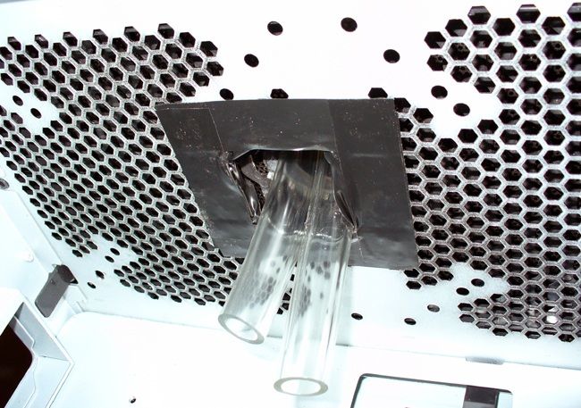

Today I cut the top hole in the case for the water cooling tubing and fan wiring. It came out very good.
Prepping:
In the process of cutting:
Cutting the second under layer of metal:
Top inside of the case finished:
Top outside of the case finished:
I used a rubber grommet so it looks pretty clean. My next step is to paint EVERYTHING black (including all screws and such). Once I do this than I can start putting the thing together :)

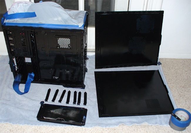

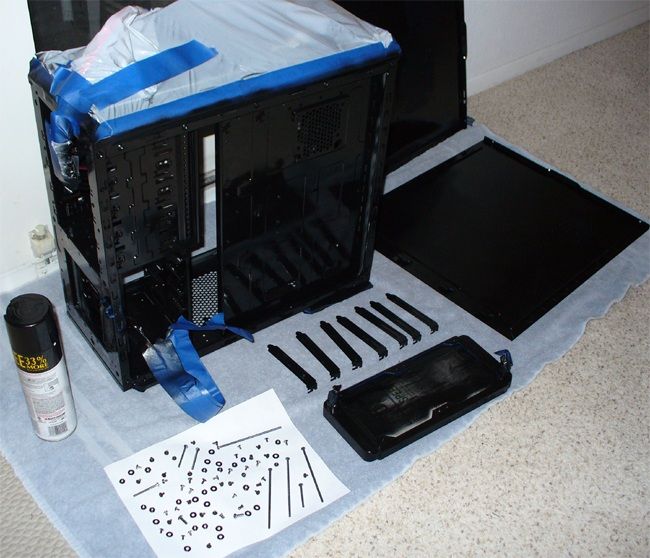

Yesterday I figured out that I am not very good at spray painting. I was having a tough time as it was windy outside (just my luck). Eventually I got a decent first coating over the radiator, case, and screws.
I still have to get full coverage on all the screws, nuts, washers, ect. and am debating between a a complete 2nd coat. The current coat the case has on it right now is pretty thick and since I wont be messing with it too much (once it is built) I wouldnt imagine its durability needs to be absurdly good. I'm going to let it dry for another day and see how it feels. I plan on swapping in the hardware and setting up the watercooling next friday or saturday when I have a whole day to finish it.
Sorry for anyone who was actually following along but since there didnt seem to be too much enthusiasm I figured I could take my time. Since I am now on spring break I spent the whole day finishing it. Personally I think it came out nicely.
