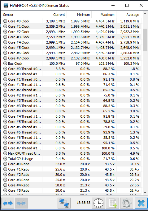

Here is my 2700X on a Msi 470 Carbon, everything default.
