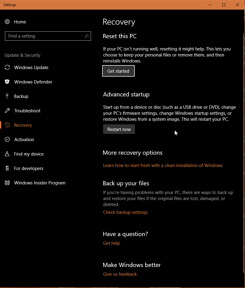

You can do a reset of the PC and it will remove all of the bloat. When I prep machines at work it is the easist way to do it on some models. Go into settings and search for Reset. Then click Get started. The machine will reboot and ask you if you want to keep your stuff or nuke it from orbit. Go find something to do for a while.

Like a champ lol. Just removes all the apps and programs and restores the machine to a fresh Windows state. You do have to go back and remove the junk Windows installs, like Bubble Witch Saga and all that.
more than that, you can even select clean state so it will install without any kind of bloat (not even sponsored games)
