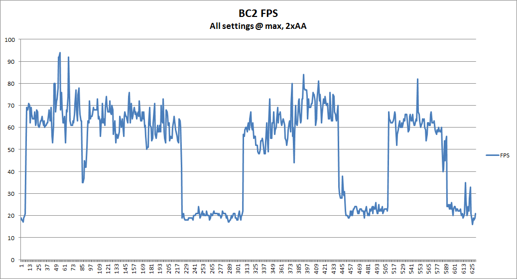

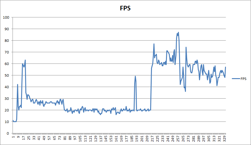

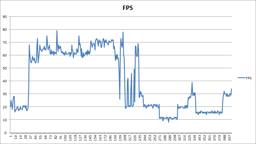

Pretty sure CrossFire (with any cards) is broken in BC2. For example, my 4850s:
My 5870's run BC2 in xfire just fine, single and eyefinity (5760x1080). There are also plenty of benches showing crossfire works fine in BC2.
