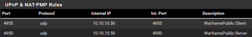

The pic below shows that the pfSense is getting the UPnP requests and creating the appropriate rules.

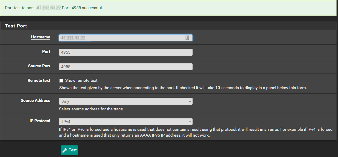

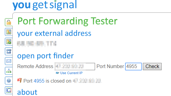

Furthermore, I can use a port checker to see if the requested UPnP ports are actually open.... they aren't.
However, if I ask pfSense to check if that port is open, it succeeds.
I do understand that the Port Forward test failure could be because the UPnP forwards are using UDP ports.
