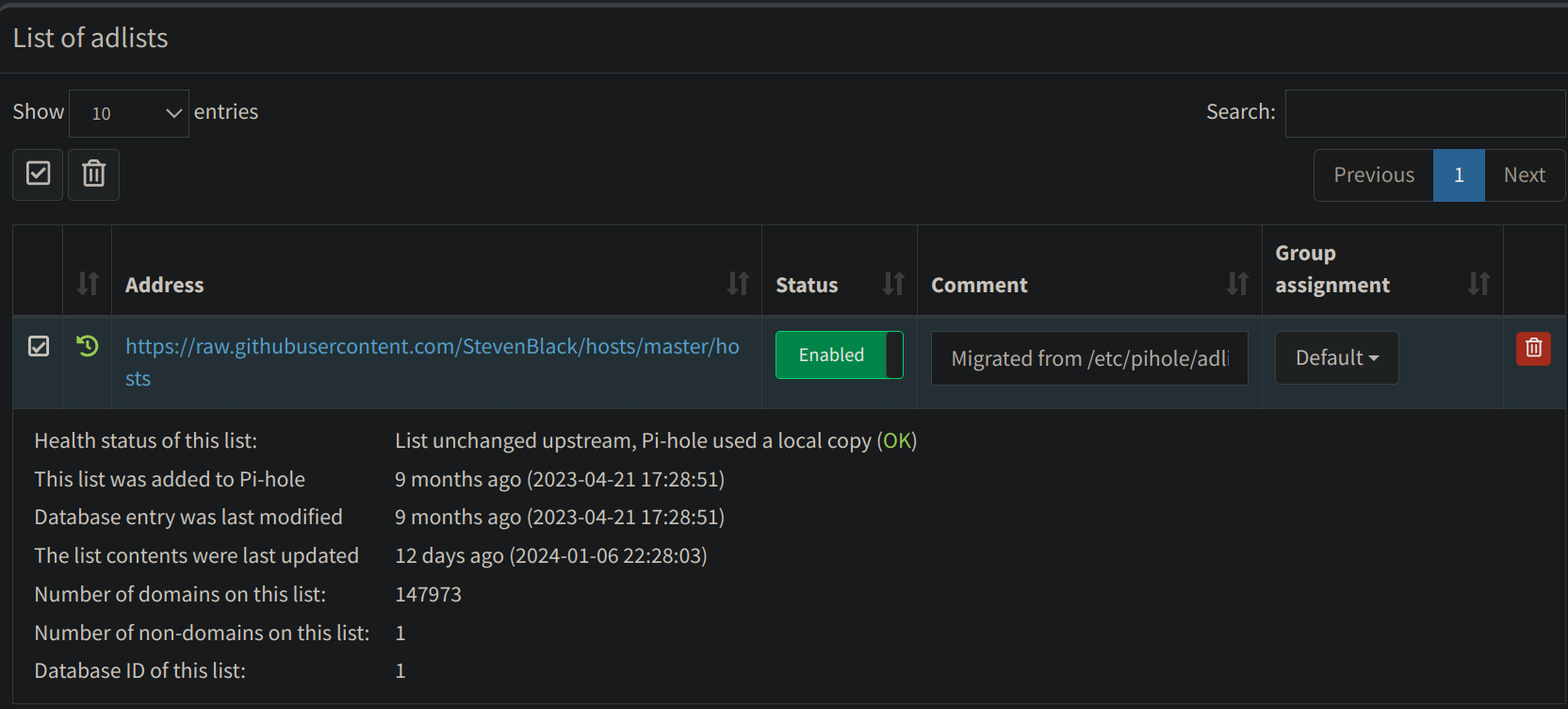

Not sure I know what a "go to adblock list is. Does this tell you anything?
Was just curious how nerdy you get with pihole... Somepeople add their own lists here.
I tend to get as nerdy as I have to but no further. Pi-Hole works excellent right out the box, I've never felt the need tweak it. But then again, I may not know what I'm missing. :(
OK. after a little research I added a few more lists from github. Thanks. (y)

I add many of the lists from Developer Dan. https://www.github.developerdan.com/hosts/
I find that between the default list and DD lists I'm covered very well.
Recently I did add a few more that is probably a lot of overkill, but my children are getting adventurous on the Internet so I have a filter that blocks a whole shitload of stuff they don't need to be exposed to yet.
Thanks. Just added a couple more. (y)
