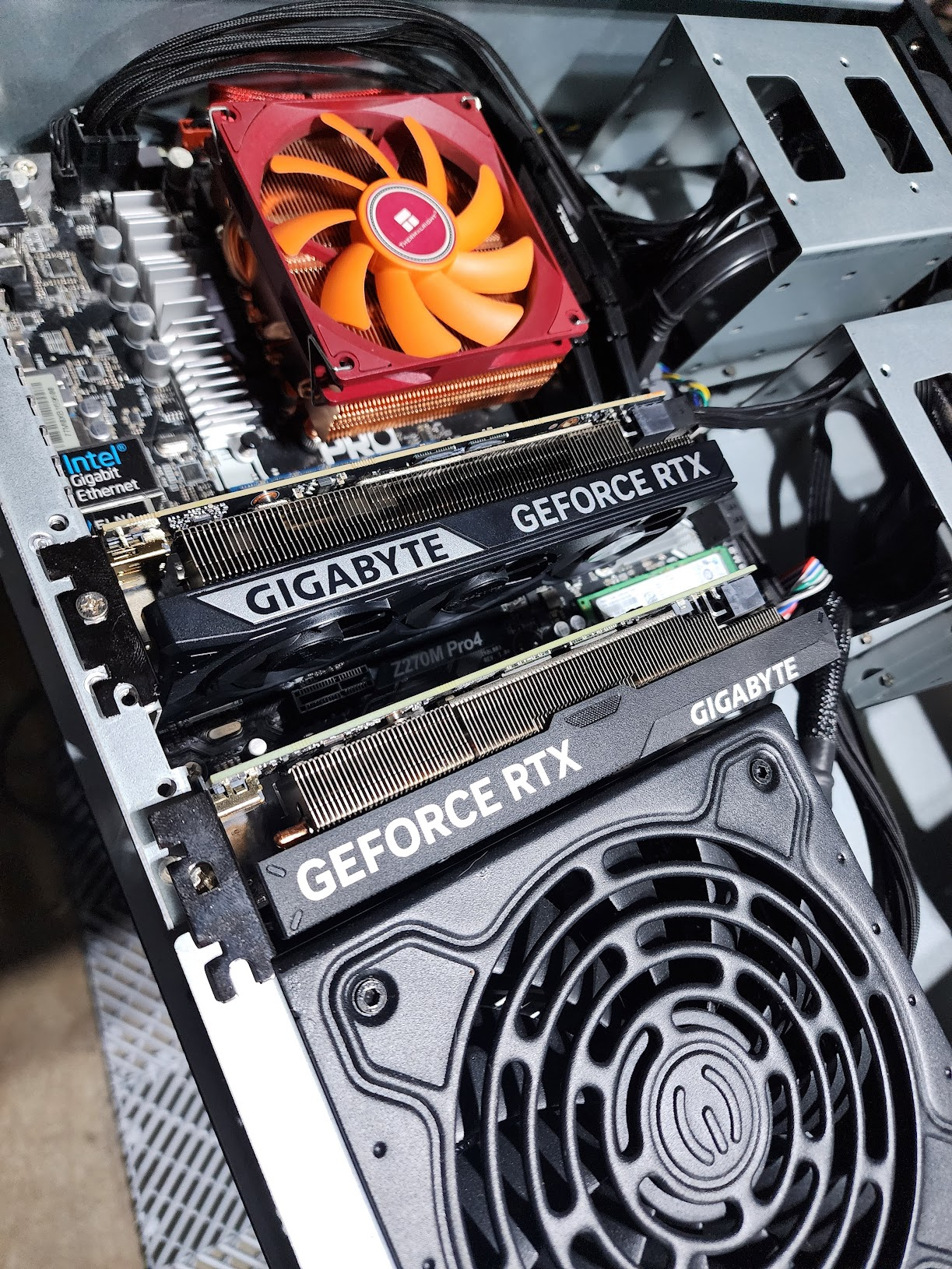

Swapped a 4060 out for a 5060 which is on an older board with a gen3x16 slot. My test bench is apart right now so I didn't try it on a newer board first.
Conveniently it's in the basement rack where I don't see it very often. So I'll try and forget about it before I find myself at Microcenter again.
Considered keeping both GPUs. The bottom card would get pretty choked out though. Could use an SFX PSU with an ATX adapter to free up some space for the bottom card. Or put waterblocks on them like all my other rigs... Every project always starts snowballing. I have other things I need to spend money on.
I was fine being blissfully ignorant.
