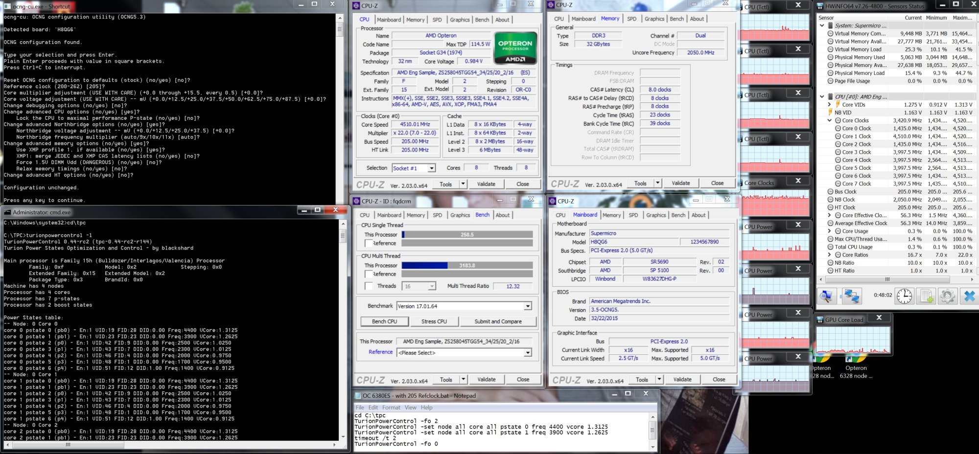

i run with this TPC script:
cd C:\tpc
TurionPowerControl -fo 2
TurionPowerControl -set node all core all pstate 0 freq 4400 vcore 1.3250
TurionPowerControl -set node all core all pstate 1 freq 3900 vcore 1.2625
timeout /t 2
TurionPowerControl -fo 0
With a ref clock of 205. This gives 4.0 GHz (all core turbo) and 4.5 GHz (single core turbo). So being able to manipulate the voltage doesn't give me too much extra.
Since you have an abundance of cores with the 6386SE i wonder if you have tried running these in "COMPUTE UNIT" setting (its in the downcore mode BIOS setting)? It saves power, but makes each core about 15-20% more efficient as it isn't sharing its L2 and various other computing resources with its neighboring core in each module.
You might also be able to up your ref clock by running this way.
i am not sure that voltage is limiting you too much. i found that the voltage requirements to increase the GHz really starts climbing after about 3.8 GHz.

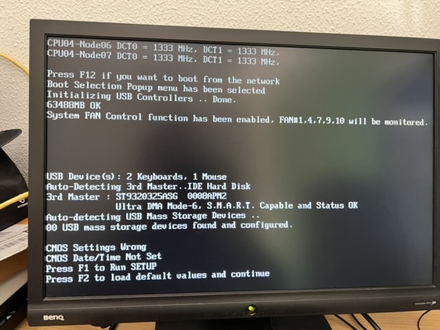

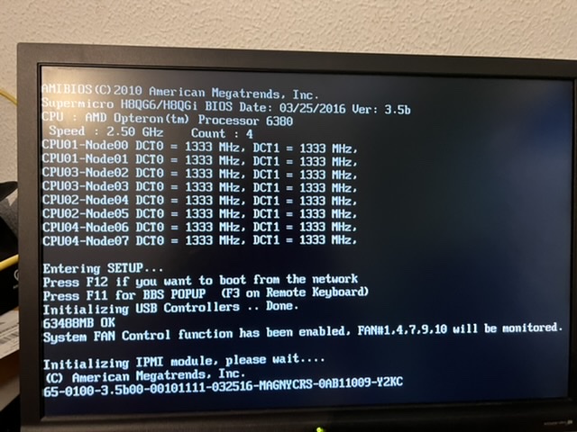

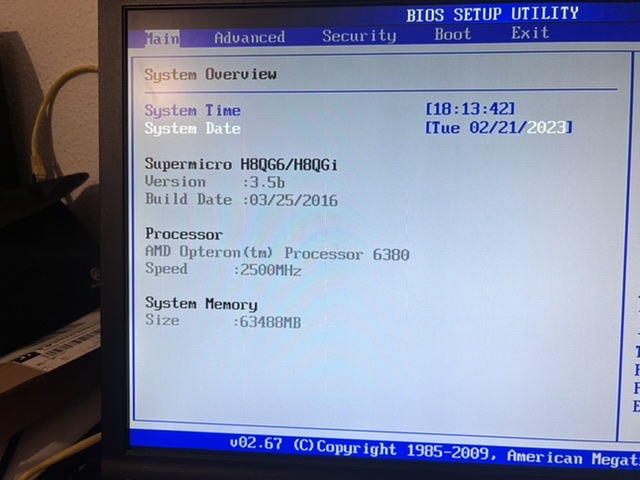

Hi, this is my first post.
I am having some strange problems with a recently bought Supermicro H8QGI+-F.
The board came with 4 opteron 6128 8core.
I tested it by booting from an ubuntu live USB, no problem. I also installed ununtu on a sata hard drive while booted.
Then I upgraded to 4x 6380 - 16 core opterons and problems started.
It was impossible to boot.
After reading I realized my Bios was 2.0 on chip with sticker (H8QG6 2411). So I flashed the amibios 3.5b available on supermicro website. (Could not find version 3 or standard 3.5)
Now it should support the new processors but the problem I am having is that it will only boot from a live usb with linux. It will not boot to the hard drive. I tried windows y ubuntu and no matter what boot order or sata, legacy, ahci or whatever configuration I change. It will not boot.
Fuethermore, once I boot (when cold) it will post without problems and supermicro screen appears and can go into bios settings. If the server has been on for a few minutes and I restart, I can no longer get into bios settings, nothing shows up on screen, no beeps on the motherboard. In order to start testing again I must wait for about 10/15 minutes and start it up.
I am getting really frustrated and can’t seem to find the problem.
It’s as if the bios was remembering the previous error and starting up in the same state that it was shut down.
I disabled ipmi jumper and that has made things a bit quicker but can’t find a solution.
Would flashig the OCNG5 bios solve this problem?
Thank you very much.

View attachment 551044View attachment 551046View attachment 551047
I have all dimms populated while having this error. 32 x 2gb non ecc 1333 mhz. Today I removed some sticks and left 4 dimms per processor and booted into ubuntu, windows and worked normally.
Processor 1 populated slots 3a3b4a4b
Processor 2 populated slots 1a1b2a2b
Processor 3 populated slots 3a3b4a4b
Processor 4 populated slots 1a1b2a2b
Moving around ram seems to make the issue reappear.
When processor 1 populates slots 1a1b2a2b, everything stops working.
Is there a configuration in bios I am missing out on?

Have you run memtest86 or memtest86+ on the ram? i would do this first to determine if you happen to have a bad stick(s). Is all the ram the same brand and type?
If you find that you have a bad stick then its going to be trial error to find which one. Not a fun experience, after i flashed OCNG, i found that had a stick that would run perfectly fine at ddr3 1333, but not at its rated ddr3 1600.
Also... prior to installing the processors, i always swab down the contact pads on the bottom of the processors with rubbing alcohol to make sure all contacts are clean with no remnants of any heat sink paste.
As far as i can tell, OCNG is based off of BIOS version 3.5. i would get it running properly using the stock BIOS before going with OCNG.
Hi, I could finally test all 32 ram sticks and all memory seems to be ok. I’ve found that slot P1-DIMM 1A is not working properly. I also reseated processors and seems to be working fine. However, on some warm resets it fails to post.
I could flash ocng bios and disabled IPMI jumper and it seems to be working better.
Little update on the RAM's. Instead of the Samsung DDR3-1866 ECC Rams (which are not SPD programable) i changed them to GSKILL DDR3-2400 Module's. These modules are programable in the SPD's.
So i programmed all the RAM's like in the screenshot. Enjoy :)
PS: since that update, 243 FSB is completly Stable.

2 years later and i use still the system. I optimized a little the Timings to 9-9-9-26-34-264 instead of 9-9-9-27-36-272.
Today i put 4 Opteron 6328 to the Mainboard instead of the 6386SE. Im sacrificing half the cores for hopefully 20% more clock speed...
And the last step is then the Highpoint SSD7101A to maximize the SSD Speed. I think more than this is not possibly anymore!
