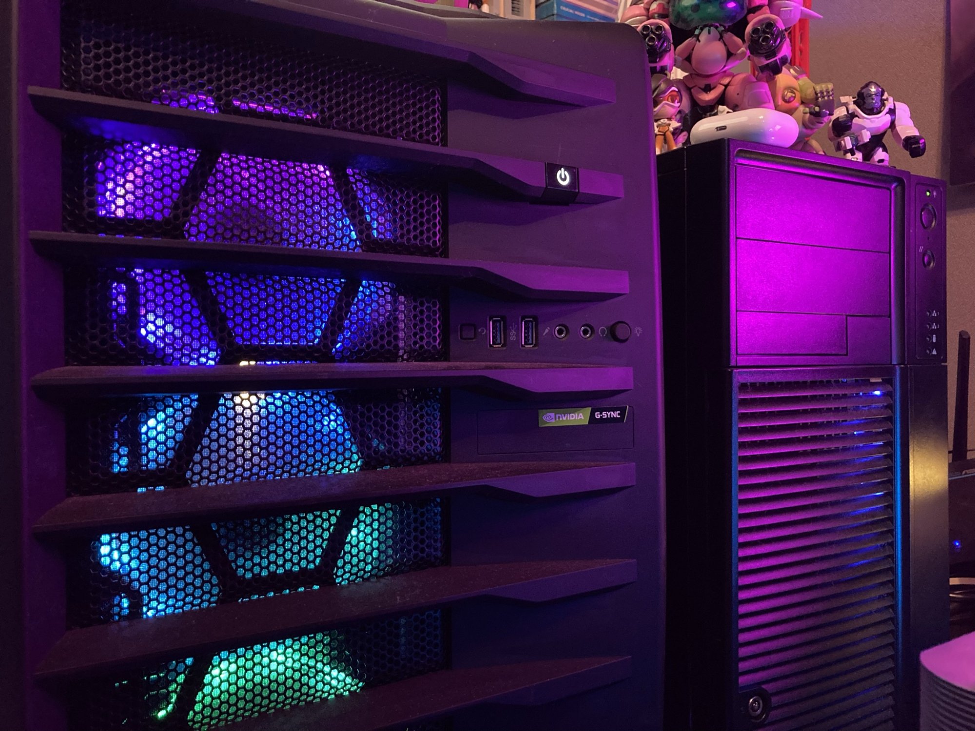

I have been thinking about modding my Air 740 case with a USB-C connector on the front.
My case has a small removable panel on the front for some option that never appeared.
That panel has the Nvidia G-Sync sticker on it,
It seems like a place like that would be ideal, since you don't have to worry about other stuff nearby. Looking at the layout of your other front inputs and buttons highlight the problems I was talking about with a lot of cases - I imagine it would be very difficult to swap out those USB 3.0 type A's for type C's or otherwise upgrade/change them. Is that removable plate below a 3.5" external bay? You may be able to slot in a bay device to at least hold the USB-C, if not an entirely prefabbed USB-C hub/splitter like https://www.newegg.com/en-labs-35fpu32puc2p-usb/p/0J2-00G2-00021 ?
it's not a bay, it's just a cover and behind it is the chassis. the front panel IO is on a board that is mounted to the chassis, I do have a spare one of those as I had an issue with the power LED not working all the time on the case and corsair accidentally sent me the IO panel instead of the LED module, so I have both sitting here. never got around to installing the LED module, lol.
