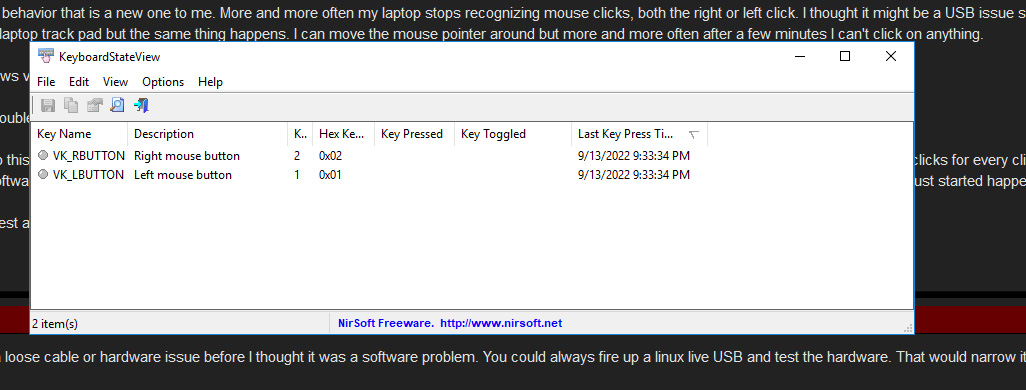

There's a little program called KeyoardStateView which can make it easier to diagnose input device issues.

Yeah, the KeyboardStateView shows input commands in real time, so it could be a tool. Or yeah, like the other user suggested just try something like this: https://linuxmint-installation-guide.readthedocs.io/en/latest/burn.html
