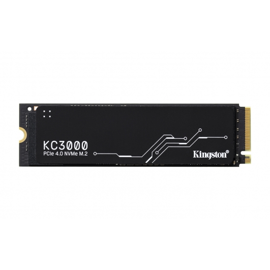

So I've never owned a NVME SSD before. My MSI B550 Gaming Plus comes with a NVME heatsink on it. The SSD that I bought is a Kingston KC3000 which has some sort of black cover on it already. So do I install the heatsink to it's heatsink? I don't want to void the warranty so should I not install the heatsink? Or am I supposed to remove the black strip and install the mobo heatsink? This was expensive where I live so I really don't want to f it up.
Image for reference:
You don't need to remove the label (and it's better not to in case you make a warranty claim), but you also don't need to use the heat sink that came with the motherboard. It's totally optional.

The SSD won't self destruct; it will throttle if it overheats. Which it probably won't.

The KC3000 throttles badly after about 90 seconds sustained write, if there is no airflow. With a fan blowing on it, it was fine, as are most of the hotter drives.
https://www.techpowerup.com/review/kingston-kc3000/7.html
You can remove the black heat foil, but not the white label on the opposite side. If you are going to do some pretty long writes, I would test it in your case at stock, with a long write, and see what the temps are. If they are bad and/or performance mimmicks what TPU found, I would remove that black foil thing and use your Motherboard's heatsink.
Yeah but you're talking about writing 500GB at max speed. For me that would be a rare event.

This makes me reweigh fussing with the heatsink when you say it like that lol hrmm...
