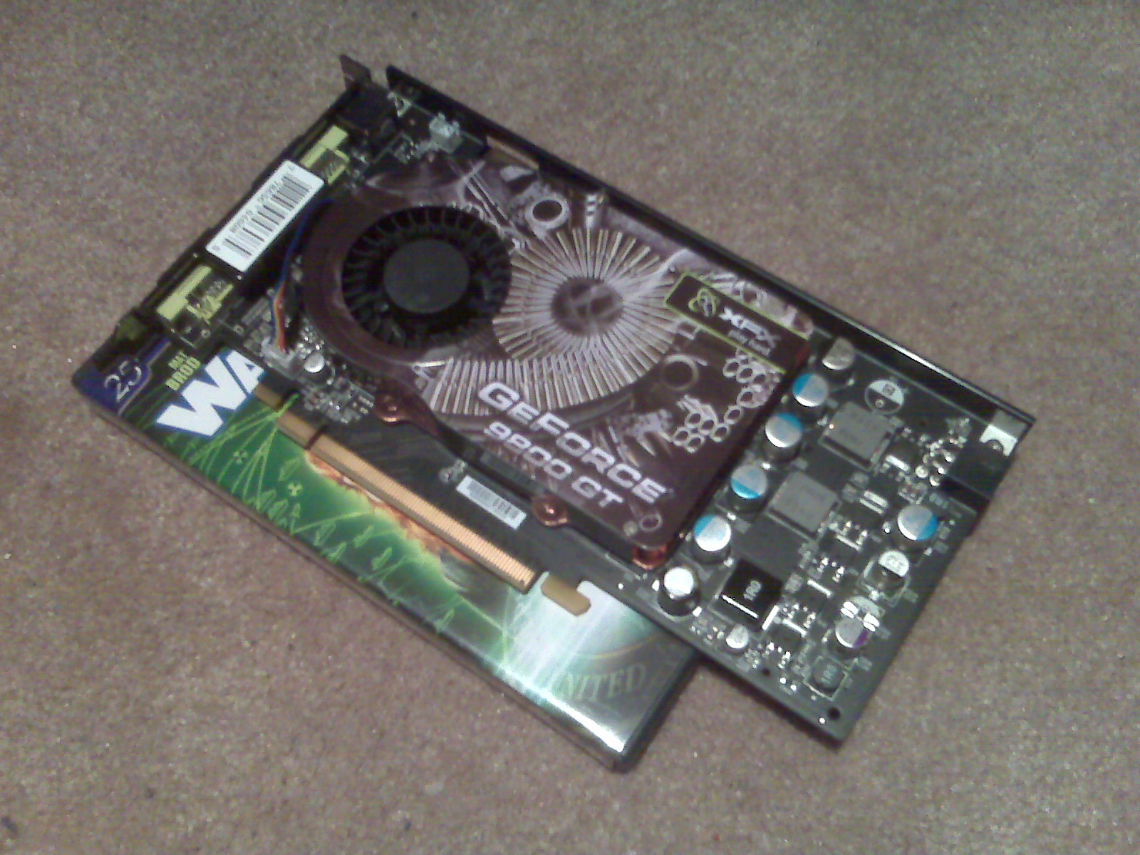

I ran my 9800GT with just the S1 and no fan at first. Even without a fan, it was much cooler than stock (plus 100% silent). I added a fan to get even more cooling, and because there was talk that the other components on the card (like the voltage regulators and stuff) didn't get enough cooling just from case airflow. I don't think it was really needed, but it was partly a project I wanted to play with.
Temps at idle/load:
Stock: 60°C/75°C (whiny fan audibly ramping up and down as I played games)
S1: 45°C/58°C (no moving parts, 100% silent)
S1+fan: 40°C/48°C (still as quiet as anything else in my case)
The S1 cut my temps by about 1/4, while the S1+fan cut them by over 1/3.
Does your card look like this one? The first pic I found of a PNY 7600GS yesterday looked more like my 9800GT's stock cooler. If it looks like the Newegg one rather than the first one I saw, it should be fairly easy to find a fan to fit for a few bucks. Even if you can't find just a fan, you can probably get a generic VGA fan/heatsink (something like the Vantec Iceberq) that fits the 7600GS and plugs into the stock connector without spending too much. I'm not sure exactly how much heat the 7600GS puts out or the mounting details, but there should be something pretty generic out there that fits it.
I was basing my Accelero recommendation on the pic I found yesterday of the more custom cooler, and thinking that you'd end up spending $10-$15+ on a fan or whole new stock cooler, in which case you might as well spend $20 and get an S2. The Accelero has the benefit of not having a fan at all. If it's just sitting in a server in a closet somewhere, you won't have to worry about the fan clogging up with dust or dying again. It's definitely not OEM, but it may end up being a reasonably priced, easy (just order and install it, no searching around trying to find something that matches the stock dimensions) option. It also fits a wide variety of ATI and nVidia cards (though the S2 can't handle as much heat as the S1), so you may be able to move it to a new card if you upgrade (not just throwing away money on an old card).
