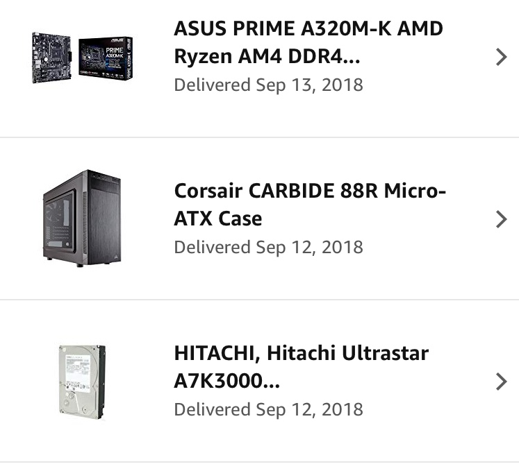

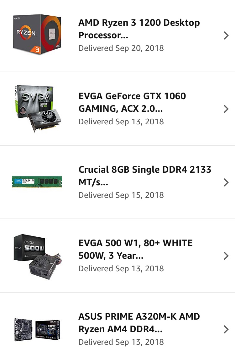

My sons friend bought these components (I wasn't consulted) and once assembled it will power on but nothing will boot. Tried both display port and HDMI. Also tried the onboard HDMI. This PSU is rated at 500w and from the specs the GPU needs 400w and the CPU needs 65w. That leaves very little room for the rest IF that is an accurate output wattage on the PSU.
Suggestions? I am going to try removing the GPU and installing it in my sons PC (same 1060/6 except it is an MSI) later.

FYI the motherboard display outputs will not work with the R3 1200 because it doesn't have an iGPU.
Also, that video card has a TDP of 120W, so you should have plenty of headroom with 500W.

Don't think Ryzen 1200 has iGPU, and GTX 1060 shouldn't be pulling 400 watts, so you should have enough power.

it should boot no issues with that PSU my ryzen machine R7 1800x with a RX 580 overclocked to 1500mhz, 16GB Gskill Ripjaw 3200mhz, 1 SSD, 1HDD mounted in a B350 Tomahawk runs absolutely with no issues in a 550W Rosewill PSU
