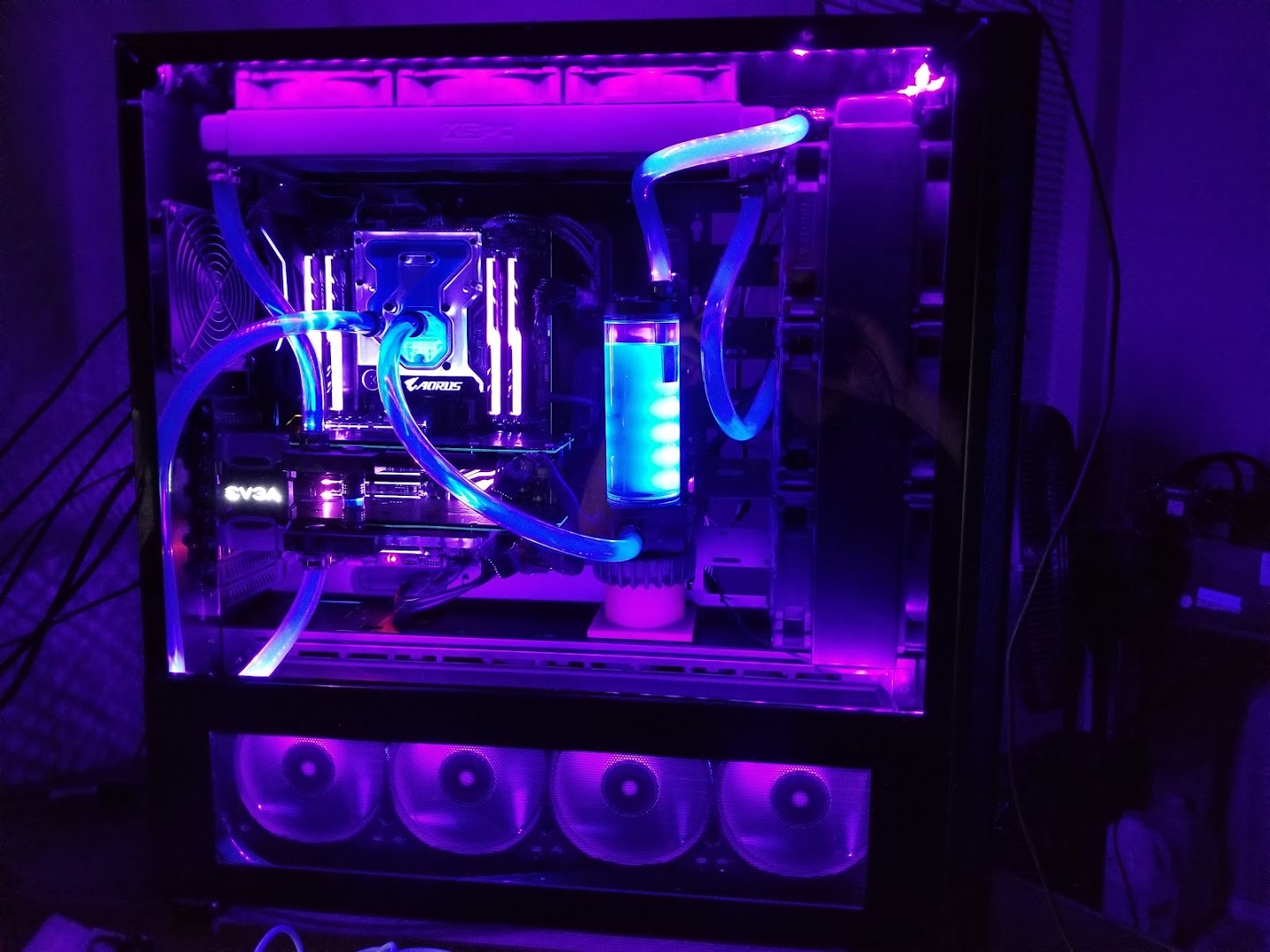

Build is still in progress and this is from a couple months ago AND the picture WAY oversaturates the UV but you get the idea #don'tjudgeme
Top radiator is an XSPC EX360 Crossflow V2 rad which is admittedly a little bit longer than your normal 360 radiator and it's 36mm thick. Front radiator is a Feser XChanger 360 Extreme and I believe it is either 62mm or 65mm thick and you can see I have it double-stacked with 25mm fans. Bottom rad is a cheap Black Ice Nemesis 480 and it's definitely 60mm thick.
The real problem comes with installation. I can't mount the front radiator upside down because it is too thick to fit with the top radiator AT ALL and it's also too tall for the mounting solution in the front as well so you are forced with a 360 this big to put it in this orientation. You also HAVE to remove everything in the front, including the front-most fans to remove the 480 rad in the bottom because there isn't physical room to get the radiator in and out otherwise and if you guessed that to get the front radiator out you need to remove the top radiator you would also be correct. So if you have a problem or just need to remove your bottom 480 radiator you have to remove the top rad first so you can then pull the whole front rad stack out to THEN pull the bottom rad.
It's also very hard to show in pictures but the crazy routing I had to do along with 90 degree fittings to get the front 360 plumbed was a bitch to do. If you see the tube hanging down to the right of my reservoir that tube actually comes out of the front 360 rad and goes through the tray to the back side of the case and then comes back through the tray to route back up to the top 360.

Are there any other cases with similar clean look/build with same specs that you were looking at when you bought this case?
I'm a Lian Li fanboy and always will be. I own a ton of Lian Li cases and I always regretted not getting a V1000 or V2000 when they were new so I made sure I bit on this when it was in stock. Hard to really pin down a comparable case unless you only care about the space because when you get to nitpicking there's really nothing else out there like this one. It really IS a very very very nice case it's just a bitch if you plan to fill it up like I did. My last giant case before this was a Phanteks Enthoo Primo and while it was really easy to build in and work in and I consider it to be a nice case it also wasn't in the same league at all in terms of fit and finish and just quality feel compared to this.
Really I think if you are considering a $450 Lian Li like this your next obvious competitor is CaseLabs.

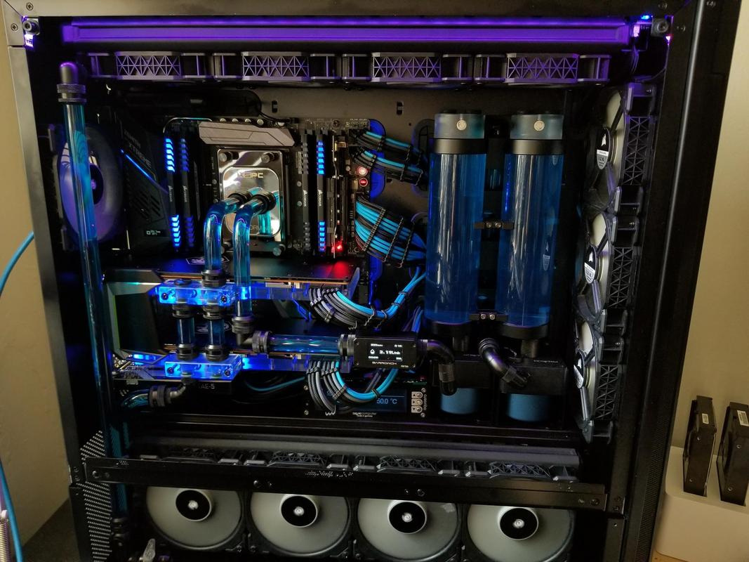

Currently swapping from 14mm petg to 16mm acrylic in mine and taking the upgraded but still crappy mono out.. I will post a pic after. I had a 360 in the top before and then i swapped it from a 480. The case upper portion is a glass box. Granted there is enough of a gap from the front for airflow I would not add a rad to the front as IMO if anything your better off without one. I have a 480 in the bottom and the top. My water temp idle is 2-3c above ambient, under load 5-6c delta ambient. 1950x @ oced + titanxp sli. My gpus @ 2012 never go past 44c under extended load. My ambeint is like 26c aprox these days.
I also had a primo I modified prior to the this case. I had a 360 and 2 480s in it. With the same components I saw no real temp change.
the primo that it replaced
Currently swapping from 14mm petg to 16mm acrylic in mine. I will post a pic after. I had a 360 in the top before and then i swapped it from a 480. The case upper portion is a glass box. Granted there is enough of a gap from the front for airflow I would not add a rad to the front as IMO if anything your better off without one. I have a 480 in the bottom and the top. My water temp idle is 2-3c above ambient, under load 5-6c delta ambient. 1950x @ oced + titanxp sli. My gpus @ 2012 never go past 44c under extended load. My ambeint is like 26c aprox these days.
Well sure you don't need all 3 rads but if you're buying a $450 case like this it looks awful empty without the front rad IMO unless you are doing dual loops or filling the space otherwise. Would love to see your build.
I wish caselabs would make something new and fresh maybe with tempered glass
Own a s8 and sma8 before. Your no where near the price at around 389 current v3000 price. My caselabs cases configured out were both in 500-650 reigon and honestly caselabs cases are nice but it's getting old. The new revision looks nice but too many out there and honestly all 95% of the builds look the same. It's under boring for me these days.
16mm acrylic

Nice stuff, i like it. Uhm the front. maybe modify it to increase airflow? Like drilling some hole to it.
