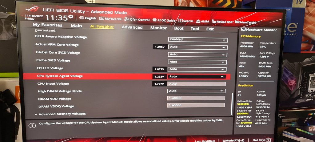

So I was going to try upping the system agent voltage as mentioned here, but just realised my SA voltage alreay looks higher than whats suggested, mine seems to be on 1.233v, it was suggested here to try 1.05v.
But I never changed my SA before, so is the default 1.223v thats its on too high?
Here is a screenshot:
I just asked my friend who is asus overclocker team, and he said that "the 1.233v for SA auto is normal, but for that freq (6600mhz), 1.0v is enough to be honest".
But I wonder that auto at CPU Input Voltage is really 1.777v???

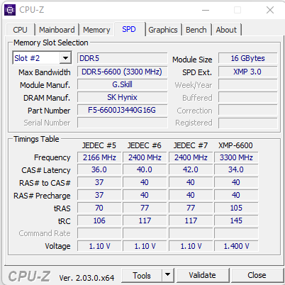

can you show me the SPD tab of CPU-Z or even better, the thaiphoon burner?
if it's Samsung, it's probably reaching it's limit.

its Hynix, not sure which die though.
Last three digits of number above barcode - if it's "20A" it's A-die, if it's "20M" it's M-die.
