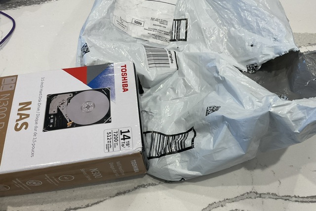

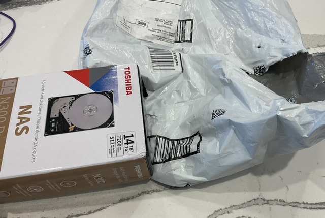

This is how they came from Amazon. Pitiful.
You're lucky it's in a box!
I've had them shipped in the static bag only loose in one of those bags!
Instant return request in that case.
I generally get mine at Microcenter or if I need bulk Provantage. They know how to ship them properly.
