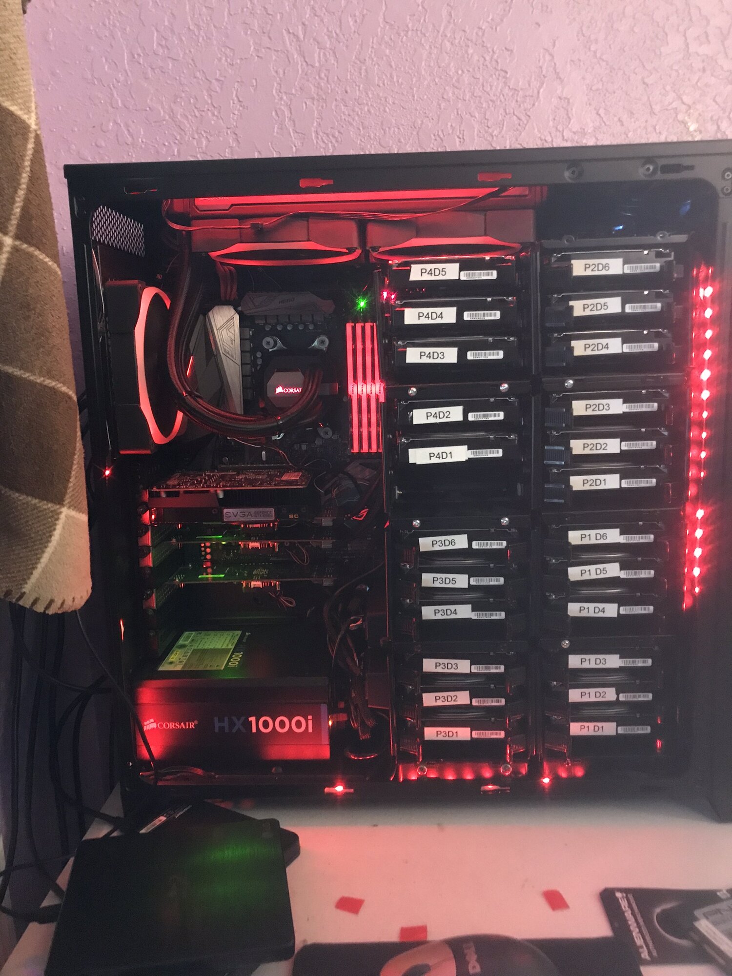

You could grab a Corsair 750D and get 12 drive bays without modification. Or use some snips and modify the case and fit 24 drives into it
(not my pic but I also have the same tower and drive setup)
What MB are you using that supports that many drives? Or do you have a RAID card installed?
