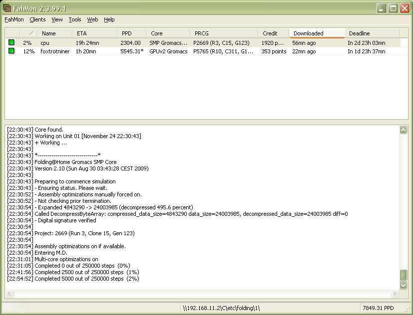

Those are some pretty high shader clocks are they not? Maybe the card is too far overclocked?
I'm pretty sure its not temperatures, as its 68C while folding. Its been working for a couple weeks without a hitch, then all of a sudden a surge of bad WUs which none were reported as bad. I'm pretty sure its the card. I'll try setting it back to default clocks when I get home tonight.
yea, thats a crazy OC, Id point my finger at that for now
EDIT
curious tho, what were you seeing PPD from that OC? Ive got 4 8800's that I cant seem to get above 1600 ish, wouldnt mind doing a voltmod if I felt it was worth it tho
This happens from time to time. You'll think it is a problem with a particular card or machine and then it will go away just like it appeared. I run 2x880gt and 3x9800gt plus one gtx260/216 and it will randomly happen occasionally to any one of them. My 8800gt's all run at 1782 shaders no problem normally but when this happens I will back the card down a step or two (i.e. 1728, 1674) which seems to help then after a day or two creep it back up. It doesn't happen very often and my theory is it is a batch of sensitive wu's. I see yours is a 5772 which, if I'm not mistaken, is a 353 pointer and it seems to happen a bit more often with those.
EDIT
The 2nd entry on my Fahmon screenshot should answer your question. Its worked for a couple weeks without any errors though which is why i'm confused its happening now.
hmm
might have to build that 4 way today after all lol
OCs are known to degrade after a while. As I said in the IRC channel, lower the GPU clocks and see whether that does anything. I'm not sure there are any other benchmarks beyond F@H to test computational stability of a GPU, else I would recommend using one :)
