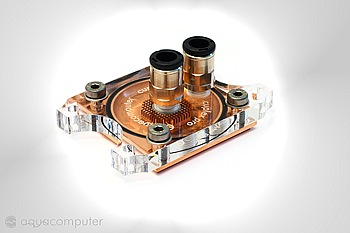

Well on asthetics a comparable cooler would be either the Cuplex Pro which arrived today in the USA (approximately $65 or so) or the Cuplex XT. Both coolers work well in 6mm and 8mm ID hose and work better with 3/8 hose. For the bling factor I would suggest either the Aquastream v 3.5 pump which gives you 1046 to 1048 flow and also bolts right up to the AquaBay if you are going with a horizontal Aquatube. The Laing DDC pump with an Alphacool DDC plexi top makes for some interesting possibilities. You can ditch the hose barb top and due to it having a G 1/4 thread you can match up just about anything you might want in the way of tubing sizes. I got one of those Alphacool tops which will be here on the next Sharka shipment. You may have to drill some additional holes to mount the DDC onto the AquaBay.
